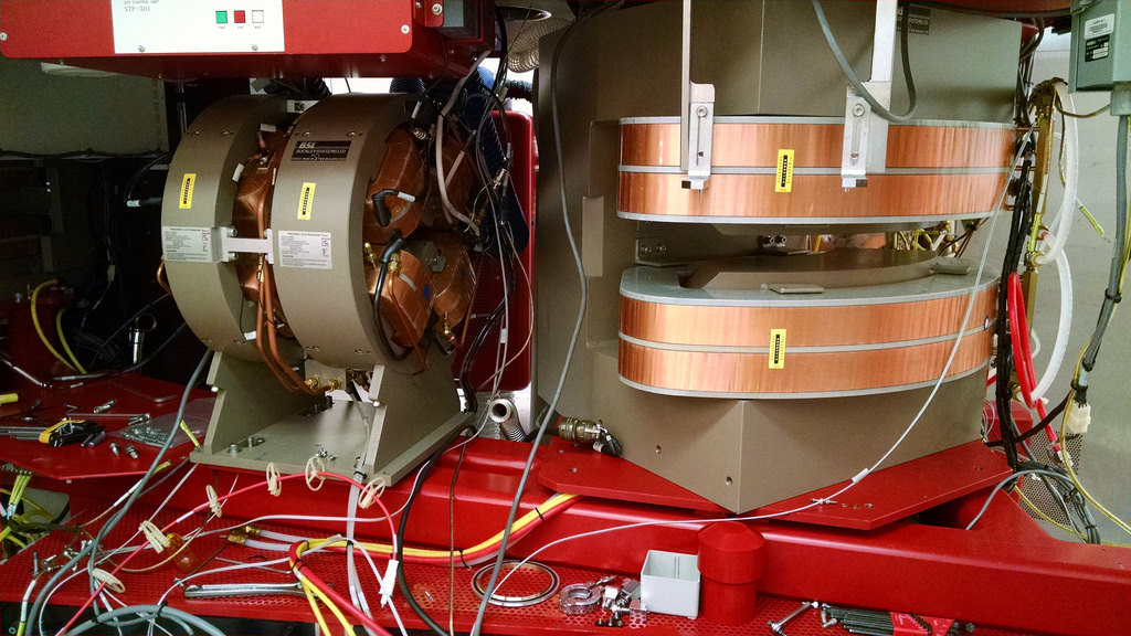

What counts for strength of an electromagnet is the current times the number of turns. You can use thinner wire to get more turns, but then it will have a lot of resistance and will heat up. Thus the key to a stron magnet is low resistivity of your wire and good way of keeping it cool so the isolation doesn´t break down. See for example this video of how a super strong electromagnet is constructed
