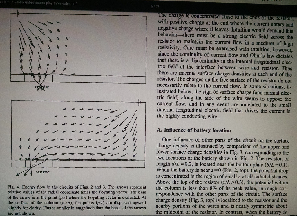

This conversation with the OP is not about Chabay & Sherwood (A proper physics correct book that explains surface charge transients and steady state configurations in wires nicely).
https://forum.allaboutcircuits.com/threads/drift-velocity.63766/#post-489233
It's completely about trolling forums and newsgroups for IMO some strange reason that has persisted for years..

There is no confusion at the OPs end, every detail here was discussed ad nauseam years ago. Coulomb interaction, electron mobility and surface charge are all well known and understood effects in electrostatics.
https://electretscientific.com/author/ajp/1962ajpv30n1pp19-21.pdf
It's just that they are usually not explored IRT low voltage DC circuits (in HVDC circuits the effects can be important) but the effects of surface charge are important in driving current even if the actual physical differences along the good conductor from the effect is only a few atoms (the Coulomb force is monstrously strong and electron mobility in a good conductor is very high) from the 10^19 electrons in those wires at 1A.
http://adsabs.harvard.edu/abs/1996AmJPh..64..855J
https://iopscience.iop.org/article/10.1088/0143-0807/28/3/020

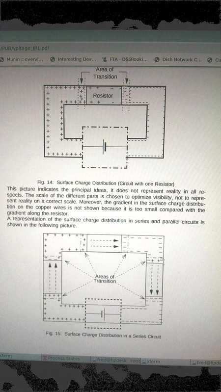

I am sorry to say your conclusion is false.
(a) there is an instantaneous rearrangement of surface electrons resulting in...
This cannot happen since it takes a finite amount of time to rearrange the electrons.
instantaneous: adjective: occurring or done in an instant
instant, noun: a very short time (as the time it takes the eye to blink or the heart to beat).
Chabay & Sherwood: "We know experimentally that the appropriate surface charges are established very rapidly in a simple resistive circuit, because we do observe a steady state almost immediately after connecting the circuit or bending the wires." (https://matterandinteractions.org/wp-content/uploads/2016/07/circuit.pdf, page 8).
Hermann Haertel: "When a voltage source is applied to a circuit, the change in charge distribution travels like a wave-front through the circuit. This conclusion follows from the principle that there is no action at a distance but that a change can only be transmitted continuously in space and time. (Fig. 2.22. Change of Voltage) Knowing the speed of light, it can be estimated that for a circuit of a length of 1 meter, the time to reach a new state of equilibrium is something like 10^-8 seconds." (http://www1.astrophysik.uni-kiel.de/~hhaertel/PUB/Quality-Electricity.pdf, page 29).
(www1.astrophysik.uni-kiel.de/~hhaertel/PUB/Voltage-PdN.pdf, pages 4-5) Note that this particular rearrangement of surface charges does not require a closed circuit.

Consider what happens when you bring the metallic conductor towards the charged plate.
Charge distribution already occurs even before the conductor makes contact with the plate.

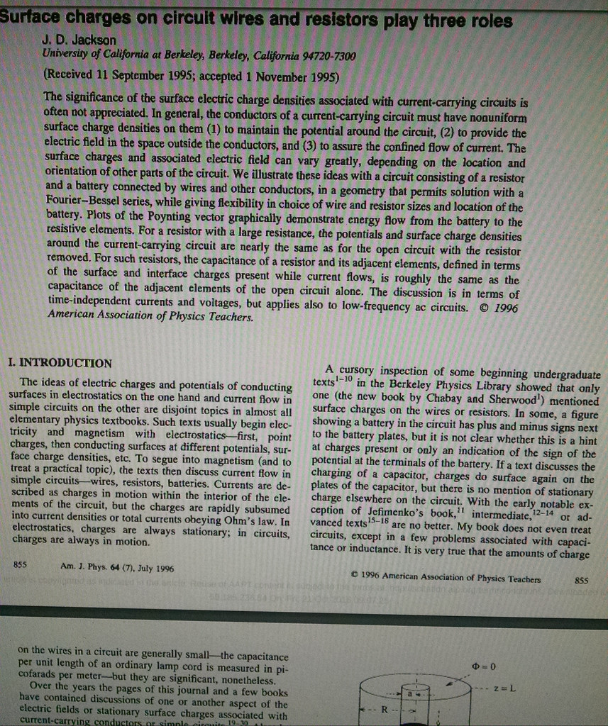

No doubt. But more significantly when contact is made. Surface charge distribution and re-distribution is very dynamic and serves at least three purposes (as nsaspook pointed out above):
What's your point?
