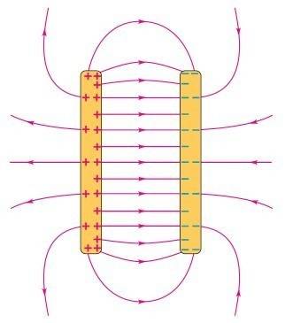

Okay, let's talk about the second of those two diagrams:
It appears that the field is related to the opposing net charges in the wires (indicated by the + and - symbols in the diagram). Since this field must reverse itself many times each second (we're talking about AC power transmission lines) don't those net charge concentrations have to reverse as well? How, then, can it be that "the electrons inside [the conductor] are not affected"?
The are affected only to the extent that in one wire they are slightly more closely packed and in the other slightly less packed as determined by the voltage/electric field.
You can look at the wires as the two plates of a capacitor (with a very low capacitance per unit length).
Thinking about it, this is because the wires have some capactiance, and now it seems that there is no way to clearly explain what is happening if they are neglected, so thinking about electric fields only without taking capacitance into account makes no sense.
So, even though the conductors are perfect, and inside the conductor the charge is constant, there will be surface charge on the outermost atoms of the wire, and this charge is directly linked to the voltage and capacitance between the two wires. So in a nutshell, nothing inside the wire changes, but with AC a tiny portion of the electrons that reside at the surface are being moved in and out of the wires, and there will be an AC current flowing related to the capacitance and frequency.
