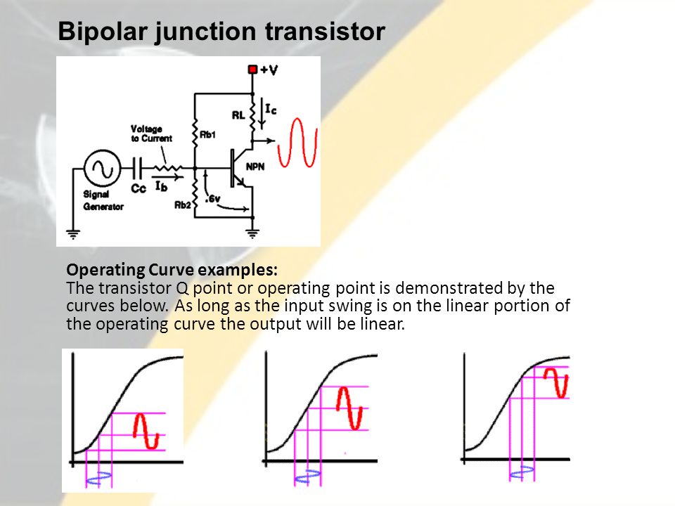

Okay maybe i should elaborate more about my doubt. From what i understand , the voltage divider at the non inverting of the opamp is what creates the DC Offset. Does that mean the circuit you drew have an offset of 6v ? So the sine wave will oscillate at the 6v dc offset ?
If you want to manipulate the signal (amplify for example), you need to change the "frame of reference" of the signal so it is between the voltages of your power supply.
Am i right to say that DC offset is needed for amplify the signal? And if i dont include the dc offset will it affect the signal?
Pardon my ignorance, i have tried rereading a lot of the post but flooded with info. Thanks for the help

Will this work ? And does the voltage at the non inverting have to be 2.5v ? And what does the offset do in this case. Can i just pull down the resistor on the non inverting side to gnd ? 0V
AnalogKid
Joined Aug 1, 2013
11,055
Not quite. In your drawing, the signal "after capacitor" will be sitting on the 2.5 V pedestal. This will be true if the DC portion of the microphone signal is either above or below 2.5 V. The capacitor is charged up (or down) by current from the opamp output through R2 and R1. Since these resistors usually are larger than the 1K pullup resistor at the microphone, they set the time constant and determine how long it takes for the coupling capacitor to match the voltage difference imposed across it in the steady state condition.
The opamp output does whatever is necessary to make and keep the voltages at its two inputs identical. Since it cannot change the + input, it changes the - input through R2. This creates a "virtual ground" at the R1-R2 node, a point that the input signal cannot change directly. The input pumps current into (or out of) the R1-R2 node through R1. Since R1 and R2 form a voltage divider between the microphone and the opamp output, this attempts to change the voltage at the - input. The output voltage changes in the opposite direction to increase or decrease the current through R2 to bring the - input back to 2.5 V. If you put a scope on the - input you will not see the audio signal, yet the output is an amplified version of the input.
