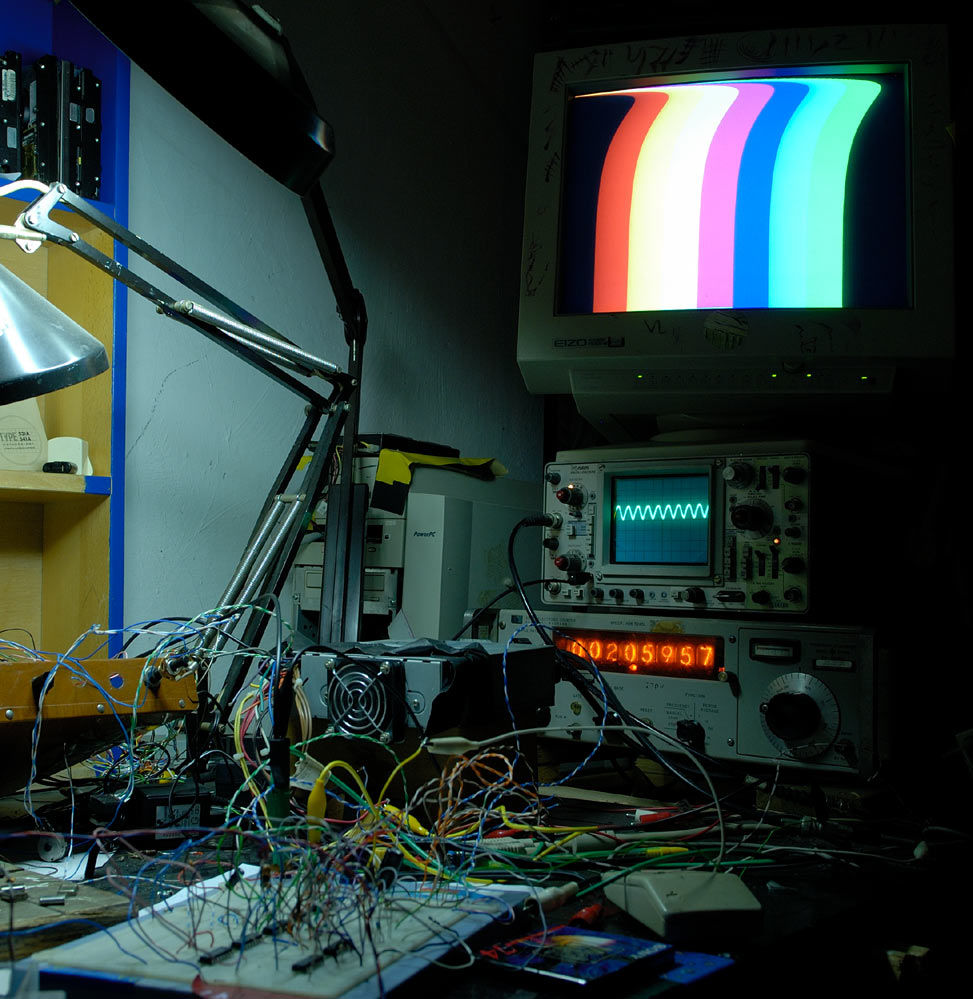

Is this part of your video synthesizer that you said that you have been working on?
basically.
i cobbled together a 16f84a program to make colourbars at 800x600 SVGA resolution. actually, what's pictured there is my 1024x768 attempt which caused a skewed image.

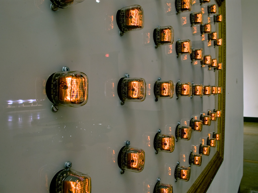

May I ask what that panel is doing...
well, yes.
each number element within each nixie-tube corresponds to the brightness of a video image. in this way, video luma 0-100 is expressed as a number: digits 0-9 and everything in between so to speak.
since the numbers within the tubes are not actually stacked in numerical sequence, i opted to make low luma values correspond to digits at the back of the tube, and bright levels the front of the tube, this actually makes for a neat 3D effect.
multiplexing of the nixies is synchronized to the video input, in this way, different tubes correspond to different areas of the video image.

So you have a frame that samples areas of the video input and displays their scaled brightness? All that in real time?
With that context, I could call this art.
bribri
Joined Feb 20, 2011
143
well... essentially, yeah. but i'd prefer to refer to it in the pre-computer terminology of "instantaneous".
"realtime" feels so 'digital'.
ha : )
you're on to me.
the photos were indeed shot at a museum of contemporary art :rolleyes:
