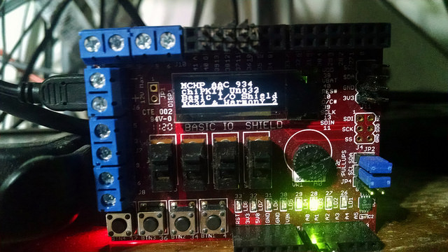

16,481
One method is to define the needed data points/commands and then create structures with the needed information about the device initialization and control.
A simple Uno32 code fragment example for the OLED display on a chipKIT I/O shield.

We then define standard cmd/data values, create a structure (oled_ssd1306 from oled_init_data) to group the cmd/data values in a easy to use and understand format. Initialize the structure (the method used here might not work with older C compilers) and then create a pointer (oled_ptr) to the data structure (used here as an example) to make it possible to use more than one display device type in the same program.

Here we use the oled_init_data structure to send data/cmds via the SPI port using XC32 and the Harmony 2.0 SPI dynamic driver. For the last DRV_SPI_BufferAddWrite function the oled_ptr is used as a example instead of the direct oled_ssd1306 structure variable.

Application display state machine C code block.
