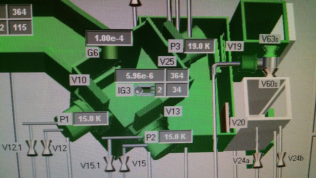

16,539
Just my observation: the absolute temperature is a "natural temperature scale" as radians are a "natural unit of measure" of an angle and "e" is the base of the natural logarithm. So it seems (at least in my humble opinion) that there should be a unit of absolute temperature that could be substituted directly into any equation involving temperature without using "degrees". So why not just use Joules (or other appropriate measure of KE) to express the molecular velocity?
K does equate to KE or molecular velocity in applications like this were K is also a indication of the effectiveness of gas capture in UHV systems. Pumps 1,2,3 are absorption pumps that trap gasses in a cryogenic array of pure carbon. K gives the required information for a quick mental calculation of pump efficiency, pumping speed and array condition for each type of pump. P3 seems to need a little attention as the upper limit is 20 K for normal operation.
