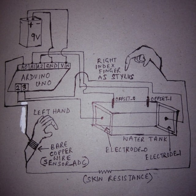

i cooked up an idea for my new project
construction - a cubical bowl of tap water , 2 sheet electrodes for 1 pair (y-axis pair)of opposite face(square wave 10Hz 10v vpp), 2 sheet electrodes for the other pair (x-axis pair)(similar square wave lags by half cycle )
left hand touches adc pin. right hand touches water surface.10v drops linearly with normal distance from pulse electrode
process adc input for realtime x-y coordinates of touch (maybe z also if added 3rd pair electrodes at surface and floor)
so water surface can be used as touch pad .
will this work?

You are going to need a lot of filtering to separate your wanted signal from all the interference.
Why did you opt for a 10Hz signal?
Does your bowl/electrode system have a reliable ground connection?
What is the approximate resistance between opposite electrodes? (Your ADC may well require a low source impedance).

That is how the Koalapad touch input device sold for Atari games in the 1980's worked, except it involved plastic sheets with conductive coatings rather than bowls of water. Per Alec_t, you will be in for an interesting filtering experiment.

The input impedance is not the same thing as the source impedance required for the ADC.
Google "arduino adc impedance" and you'll see that the ADC really wants ~10k as the source impedance. So the water impedance is ~ ten times too high for reliable ADC measurements. A buffer amplifier seems necessary.

Can the Arduino accept 10v at the analog input?
since resistance of water bet opposite electrodes is 100k
voltage divider must have resistors in order of 10 Mohm for 1% error

If instead you use a 5 v source you need not use a divider, but you are still left with the impeadance issue raised by Alec up above.

shouldnt the source impedance be equal to skin impedance , not the water impedance as you said

I did it , I built a water touchpad sensor to track the position of my right index fingertip on a water surface! . Here's the Youtube video link -

Here's the Arduino c++ code for the project DIY Water Touchpad
Code:
/* Project Title- DIY WATER TOUCHPAD
   Author- Sumit Aich
   Project Summary- The basic idea behind this sensor is the use of a parallelopiped water container
   as a water potentiometer device. It is similar to a 3-pin slide pot used in electronic circuits,
   with the 2 aluminium electrodes equivalent to the 2 end pins of a slide pot,
   and the right index fingertip is equivalent to the middle pin (voltage output) of a slide potentiometer.
