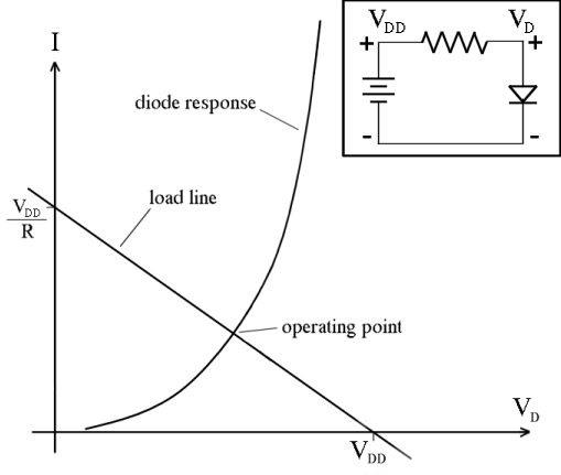

We don't really know that the voltage across the LED is 2,2V. That is simply an educated guess based on past experience.
To arrive at a more correct voltage you either have to know the I/U equation of the LED or you can use a graphical solution by superimposing the resistor load line on top of the I/U curve of the LED (I/V curve for non-Europeans).
Where the two lines intersect will give you both the current and voltage of the LED.

One property of diodes (including the light-emitting kind) is that when they are forward biased (i.e., conducting more than a tiny amount of current) they have a roughly constant voltage drop across them. For an LED, this voltage drop is primarily a function of the color. So, in most cases, a red LED is considered to drop about 2 V to 2.2 V. If you double the current or cut it in half, the voltage will probably only change by about 20 mV or so. As a result, we can usually just assume a fixed voltage drop in that range and get results that are "good enough".
So with this in mind, we have that
5V = Vr + Vled
Vr = 5V - Vled = 5V - 2.2 V = 2.8 V
Vr is the voltage dropped across the resistor and Ohm's Law tells us that it is equal to the product of the current and the resistance. Since the current in the resistor is the same as the current in the LED (remember KCL from earlier), we have
Iled·R = 2.8 V
R = 2.8 V / Iled
Now we just have to pick the desired LED current. In the "old days" the usual current was 20 mA for a run-of-the-mill LED. Today is it more likely to be somewhere between 1 mA and 10 mA. But you need to look at the specs for the particular LED to determine a reasonable current. If we use a current of 10 mA, then we would have
R = 2.8 V / 10 mA = 280 Ω.
Your original post seems to have the current at ~23 mA, which would yield ~120 Ω.
Flipping it around, if the circuit has a resistor of 220 Ω, then the current through a red LED would be expected to be about
Iled = 2.8 V / R = 2.8 V / 220 Ω = 12.7 mA, which is likely to be a good current for an LED that is spec'ed at about 20 mA of current. The human eye is pretty insensitive to changes in light output on the order of a factor of two and running LEDs at half their rated current allows plenty of margin for component tolerances and will make the LED last pretty much forever.
