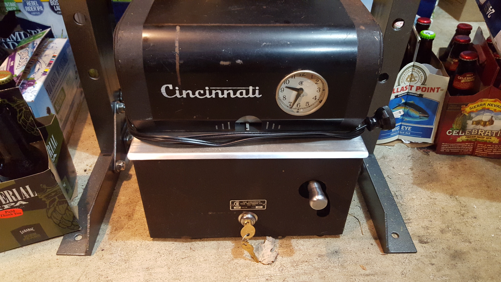

So I bought this old Cincinnati Manufacturing circa 1950 time clock machine. Really just bought it for the Cincinnate referenc e(Im in Cincy) and because it was just kind cool.
When I took it apart all the mechanicals for the clock and other mechanisms were still it very good shape. So I began wondering if, with electricity, the machine could be used as a clock.

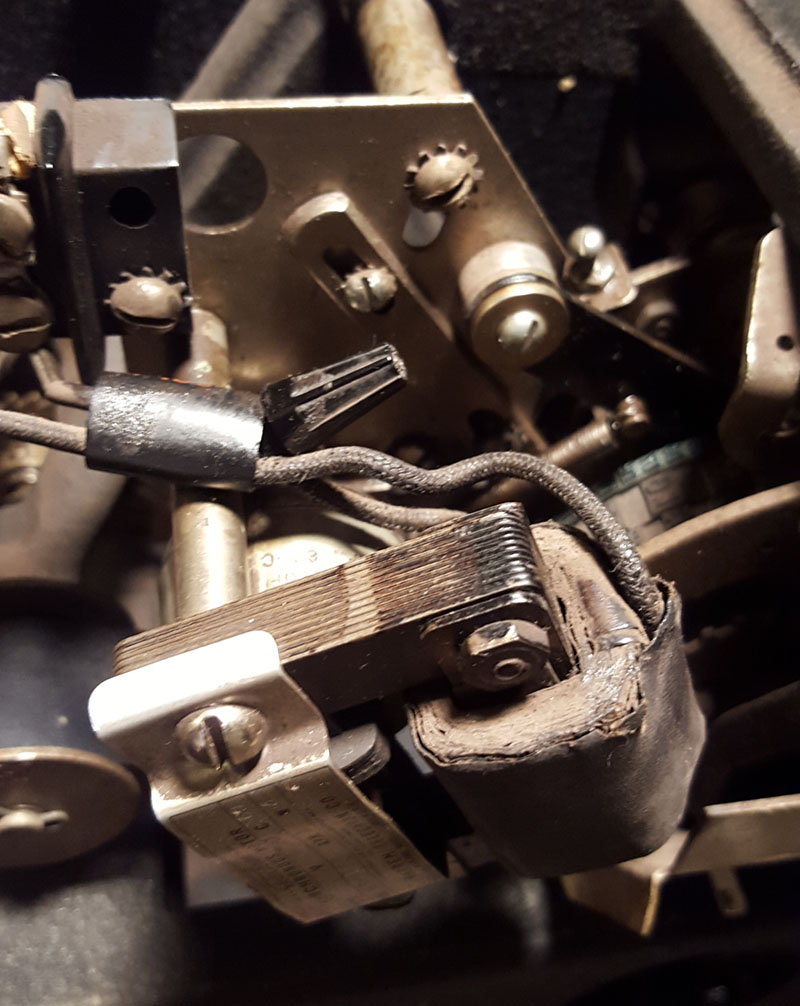

I don't know that much about electricity other than basic wiring (home, motorcycle, etc). While the electronics in here look basic there a couple components I don't recognize. See pix. Esp. the cloth wrapped components in last image.

From the photos you posted it looks like all it needs is a new power cord. Maybe use a precision oiler to lubricate the moving parts with some machine oil.

Last picture looks like a transformer. A picture of the tag on the bottom would give more clues.
Be mindful of polarity when you rewire.

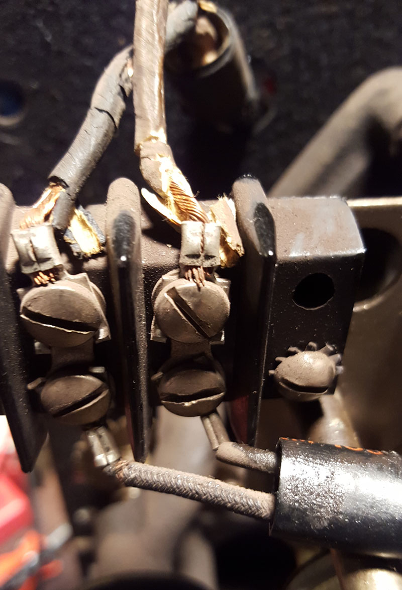

Or is the last photo the motor; I see only one coil with only two wires. Most of the insulation on just about everything looks shot, but there are no obvious shorts in the photos. If you start to remove electrical parts, be prepared for a lot of that insulation to crumble away.

If you have an ohm meter, measure the resistance across the power plug. If it reads less than 10 ohms then there is probably a problem. Over 50 ohms and I would plug it in and go for it.

FWIW: The laminated device in the 'last' image appears to be a 'skeleton-style' shaded pole motor -- and, in fact, upon 'zooming in' one can barely descry the word 'motor' on the nameplate.
When you restore the unit you will need to replace the power cord, dissemble, clean and lubricate the motor, clean any electrical (switch) contacts (which, if present, will likely take the form of linkage-actuated switch-reads bound near one end with Bakelite (i.e. phenolic) insulation --- of course the mechanical components may likewise require cleaning/lubrication...

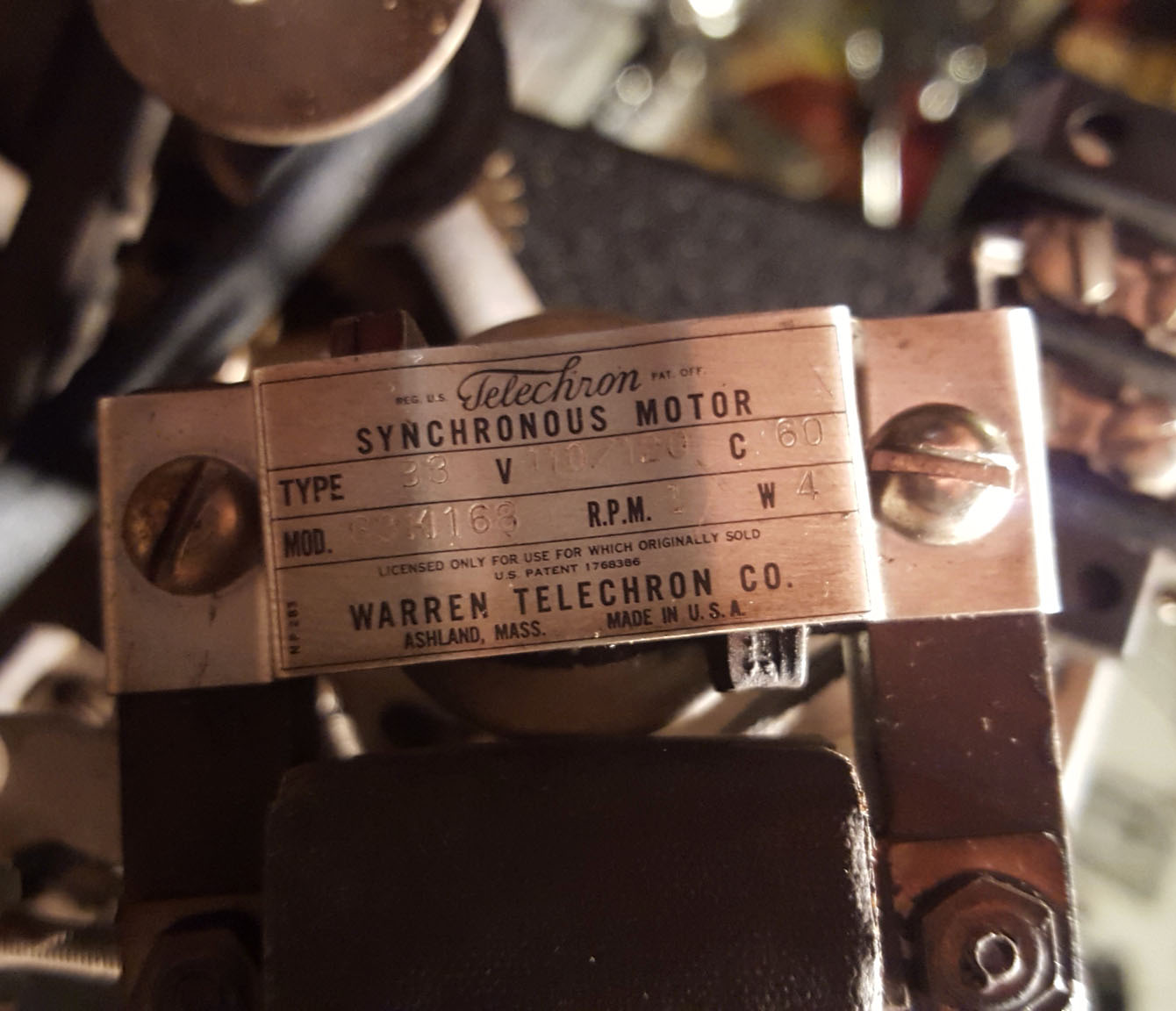

Thanks for all the input. Will try to get some more pix, although the rest is all mechanical not electrical. Here is a picture of the "Motor":

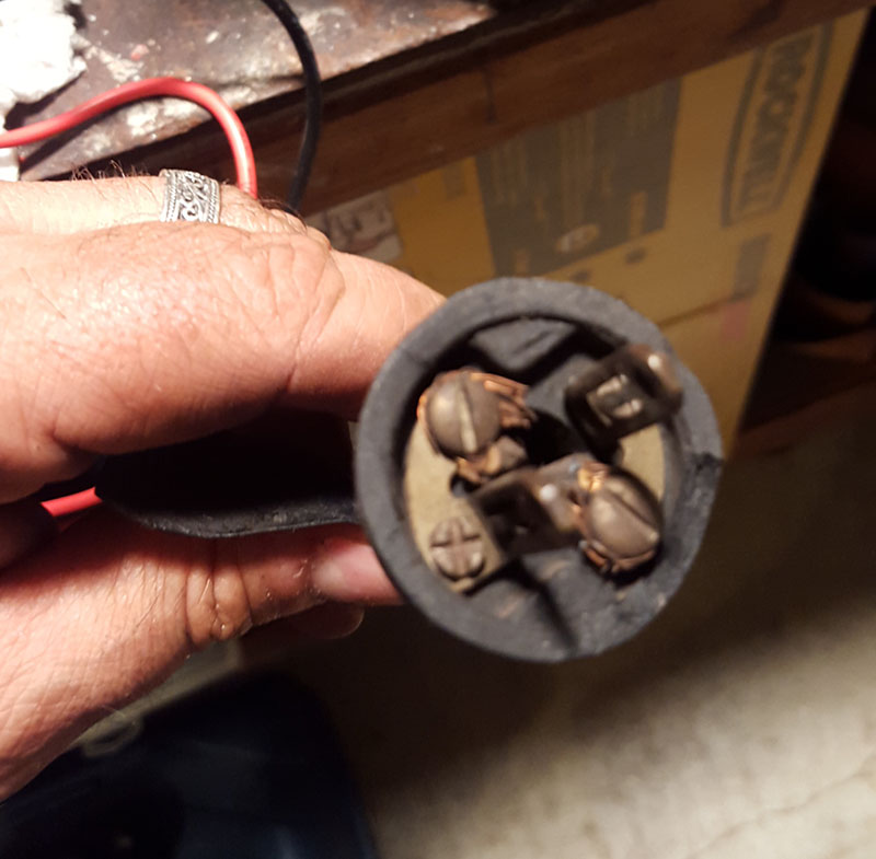

I would also like to try and replace that old two prong plug with a vintage one, but cant find anything like it online. The prongs have an odd pattern (spring type?) to them. Picture 2.
What gauge would you guess that to be in the power cord?
A 16 AWG (stranded) cord should 'fit the bill' --- If you will not be 'upgrading' to a grounded power cord/connection please consider operating the unit only from A GFCI protected receptacle...

IMPORTANT: @Todd W. Roat Please read!
I notice the numeral '1' in the AV (i.e. ' RPM') field of the motor's name plate --- This implies that the motor assembly contains a gear-reduction mechanism -- If the motor works, Please disregard my advice as regards disassembly of the motor (in post #8)! --- Should the motor fail to operate please let us know -- there are a few useful 'kinks'...

Thanks again for the help gentlemen. I got the electric fixed but as one might suspect the motor is sluggish. Turns a bit, stops, with a little nudge it goes again, stops, nudge, etc. I read a bunch of articles about getting oil inside the "can" by heating the motor then adding oil to drive spindle - as it cools at it vacuums in. Worked great. But didn't help. These motors are $100 bucks on ebay or $160 rebuilt. Not THAT interested in the project. Against what Ive read im considering cutting a door in the can motor to peek inside and see if I can get out any old dried lubricant sludge Im hoping solidified and is causing my issue. Motor is an B style motor: B3 HNK M2510 1 RPM.
