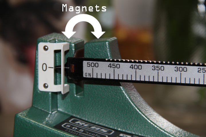

I can give you an example of magnetic dampening on my powder scales.
The magnets are embedded in the scale where the arrows point. The end of the pivot arm is turned in copper:
Ron
Yeah that is a good example. I have a powder scale as well and never realized that's what the copper tab is for. Unfortunately I think the example bolsters the argument against eddy current damping more than the argument for it. There is very little force on the end of the balance beam, particularly when it's properly balanced, so it works well.
Perhaps I am wrong. Probably so. I concede.

thank you! I am marveling at what an elegant solution that is. no bearings, no additional moving parts... genius.
This is an interesting solution but one feature of it will be that the drag varies with the speed, increasing the faster you move and decreasing suddenly if you stop. The effect may not be too great for the application, or possibly even desirable in some cases, but for a slider it *seems* to lack the sort of control you’d want.
