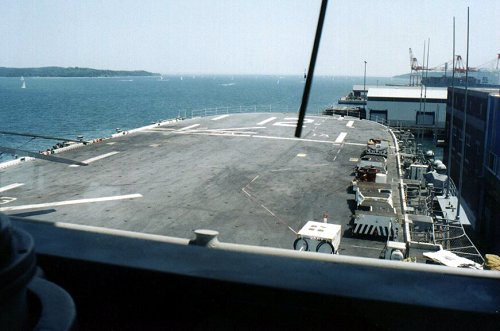

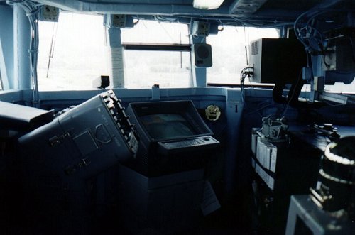

This is a picture of the last ship I was on (IWO JIMA class of helicopter assault ships ). She was build in the 60's.
Bridge view
The captain's chair is where the lady is.

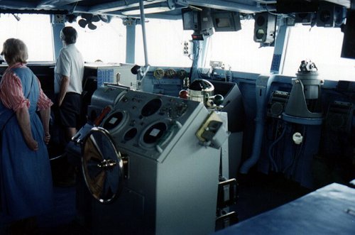

Standard old school steering and throttle on one station that could be manned by two people or one.
In an emergency control could be shifted to the AFT station or they could Override the bridge.
Starboard side bridge view radar and weapons stations.
McCain Old style helm.
McCain had recently upgraded to the “Integrated Bridge Navigation System” Helm like this. Most of the controls and indicators are on the computers screens loaded with busy small print and icons designed for office use.
The computer assisted navigation seems to make understanding who has positive control and the exact configuration unclear at a glance in a emergency when control in switched rapidly from control stations or changing modes.
When the Lee Helm lowers the speed of the port shaft to 44 rpm/100% pitch, no-one is aware that the starboard shaft is still at 87 rpm/100% pitch. With the rudders amidships, no-one is steering but the rate is increasing. They don't panic but they are unaware of what's causing the problem.
It would have been nice to have a bridge mounted OIC Override button that gave full control to the single Helm station with all systems set to a known default old school configuration so they could work out a proper solution then.
I don't think that a lack of training was totally at fault because the system seems just too complicated during an emergency. Most of the senior people in charge used the older systems and in a emergency that familiar older training tends to control your actions so they didn't help regain total control until it was too late.
