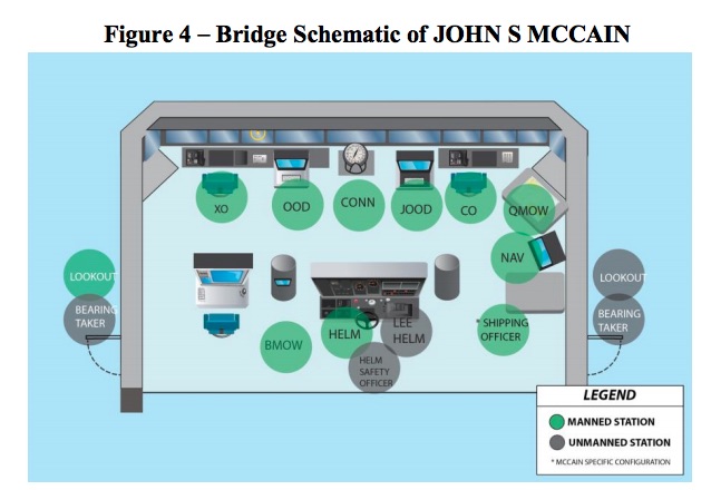

https://s3.amazonaws.com/CHINFO/USS+Fitzgerald+and+USS+John+S+McCain+Collision+Reports.pdf
McCain:
Additionally, when the Helmsman reported loss of steering, the Commanding Officer slowed the ship to 10 knots and eventually to 5 knots, but the Lee Helmsman reduced only the speed of the port shaft as the throttles were not coupled together (ganged). The starboard shaft continued at 20 knots for another 68 seconds before the Lee Helmsman reduced its speed. The combination of the wrong rudder direction, and the two shafts working opposite to one another in this fashion caused an un-commanded turn to the left (port) into the heavily congested traffic area in close proximity to three ships, including the ALNIC. See Figure 5.
https://arstechnica.com/information...-collision-ultimately-caused-by-ui-confusion/
However, instead of switching just throttle control to the Lee Helm station, the Helmsman accidentally switched all control to the Lee Helm station. When that happened, the ship's rudder automatically moved to its default position (amidships, or on center line of the ship). The helmsman had been steering slightly to the right to keep the ship on course in the currents of the Singapore Strait, but the adjustment meant the ship started drifting off course.
We never had this problem pre-automation, there was one big physical control wheel and one throttle control on the bridge with an old school voice tube down to the engineroom and steering as backup control from the bridge. Here the physical control location got switched accidentally and they lost track of where it went.
