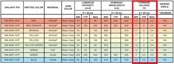

1) When bipolar switch transistor is on, saturated, its typically .3 - .6 V collector
to emitter. LEDs when on here are typical drops -
And of course the R drops some V. Sum of those 3 drops = supply rail = 3.3 in your case.

The 2N4403 should be quite satisfactory for the LED. It would be marginal if the LED were white, but for red, green or yellow it will be fine. (This is because a white LED requires about 3 V to light and you only have 3.3 V to start with, so any voltage drop across the transistor becomes quite significant.)
The IR receiver will be putting out serial digital data, so the LED will only turn on when the output is LOW. This means that the voltages you measure with a meter will be averages as the LED is being turned on and off at a speed far too high to see. A very small motor would probably be OK with this, but it would run at a reduced speed. You would need to add a circuit to "stretch" the pulses to keep the transistor turned on.
