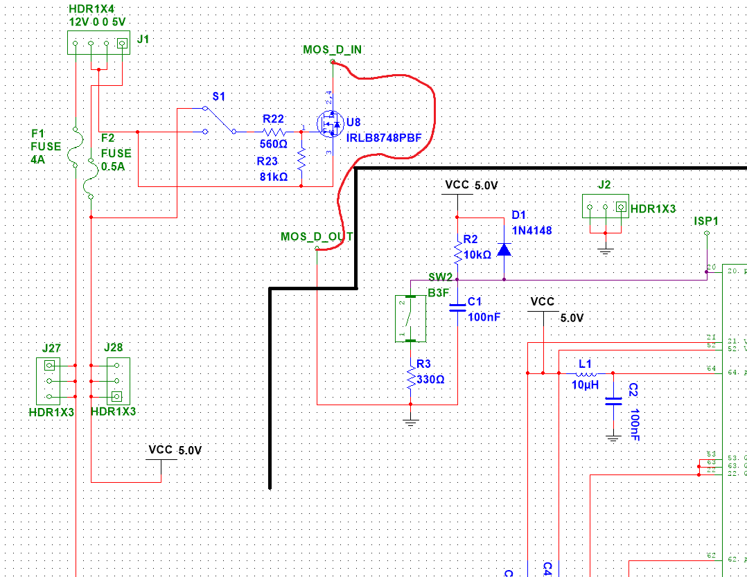

Hello,
I want to turn on my circuit consisting that uses two different voltage levels (5V for powering MCU and 12V to power other load).
Normally i would simply use DPST or DPDT switch. Unfortunately, the type i want to use, rocker switches are very big while in this particular case i need to use switch as small as possib. I decided to go with small slider switches but it was no go, the 12V powered load will be taking up to 12A of current which will most likely fry little switch.

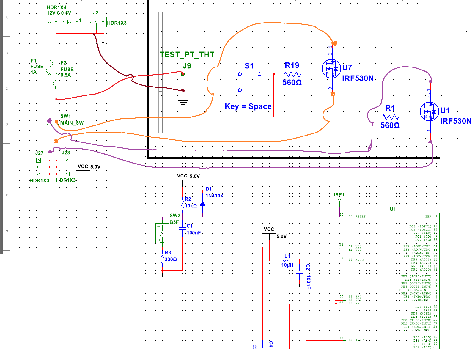

So i figured out i could use single SPDT slider switch and connect it to GND, OUT and 5V where OUT would drive two N-Mosfet transistors where each would be delivering 5V and 12V.
This is the initial schematic where i still planned to use DPST switch it was no go because of switch size:
http://i.imgur.com/oVQOKIT.png
This is my usual schematic when i want to use mosfet as a switch, i deliver 0 or 5V on the gate resistor and when the input comes from MCU i add in extra pull-down resistor :
http://i.imgur.com/xDWLBeF.png
Using above schematic as example i tried to rewire my main switch circuit to use single SPDT switch and 2 mosfets to turn on 12V and 5V. The main switch was removed. S1 is SPDT switch, it will deliver either 5V or 0V (GND) to mosfet gate (not sure if i should add pull-down resistor back to schematic):
My question is, is this way in which i connected Mosfets valid? I usually used them just to switch on/off single load and never tried using them to turn off/on a whole circuit.

Since you are using the FETs as high-side switches, the gate voltages will need to be about 10V volts above the source voltages (not ground) to turn the FETs on fully. So the 5V switch and 12V switch would need gate voltages of about 15V and 22V respectively above ground.
Try the FETs as low-side switches instead.

I redesigned circuit to use N-Mosfet as low side switch, this is overall schematic, i know its zoomed out too much but just wanted to give idea how it looks, but the point is, both Vin 12V and Vin 5V will be connected directly to circuit that they need to power
http://i.imgur.com/MZ9VR6G.png
but then, every single GND point from circuit (12V and 5V share common groun) will be gathered in one place i called MOS_D_OUT (but wont be have direct connection to GND from power source) and MOS_D_OUT will be connected directly to N-Mosfet Drain pin and there a signle N-Mosfet transistor with a single SPDT switch on gate (that will connect to it either 5V from power source of GND from power source) will be switching the MOS_D_OUT (GND points from main circuit) to the GND from power source and so it will be turning whole circuit on (schematic below)

That should work, provided the 'ground' points for both the 5V circuits and the 12V circuits are in fact the drain of the MOSFET rather than the 0V rail.
