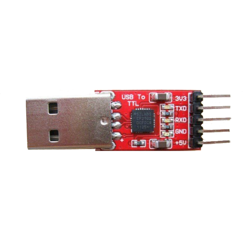

Hello everyone,
I'm using laptop...and need to watch some variables in serial monitor. Com port is not showing in serial monitor because laptop does not has serial port. I'm using mikroc? Pls help me
Thanks in advance

Google "USB serial adapter." These are available from many manufacturers and will give you an RS-232 communication port on any computer with USB.
There are also adapters which will give you a communication port with TTL-level (3.3 volts or 5.0 volts) serial I/O, such as this one, as just one example.

Thanks OBW0549. I'm woking on pic18f4550...now i need serial adapter?
Well, you need something to give your laptop a serial port, and that's what these serial adapters are designed to do.
Is your PIC18F4550 circuit going to include a complete RS-232 interface? If so, you'll need an RS-232 USB-to-serial adapter. On the other hand, if you intend to just connect to the PIC's UART (or USART) I/O pins, use a USB-to-TTL-serial cable instead.

No my circuit does not has RS-232 interface...i under stood what are you saying...i need FTDI serial usb cable...thanks for your help and time.

I would not choose a FTDI serial cable because it interfaces to RS-232 port.
I would choose a Silicon Labs CP2102 USB to TTL bridge.
