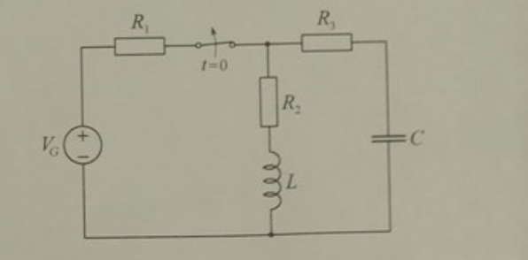

I'm having trouble with analyzing the following circuit... Needs to be done ASAP - final exam tommorow and my brains are spinning.
Parameters:
Vg = 24V
R1 = 400R
R2 = 800R
R3 = 200R
L = 0,2H
C = 0,96uF
Text: Circuit is connected like shown above for a long time and at t = 0, switch is opened, which disconnects R1 and source. Find Vc and Ic for t >= 0.
