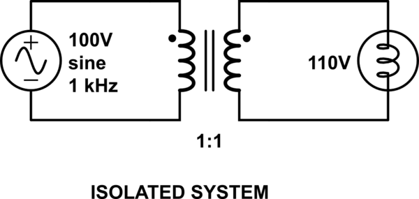

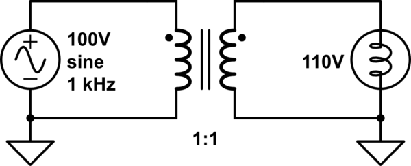

At the risk of being pedantic the opportune word in the isolation definition is 'direct conduction path' with a device that provides Galvanic isolation like a transformer IMO.
If we assume the symbols are earth ground points, the lamp circuit is still isolated from the energy source via the transformer because we don't have a direct conduction path from the source energy/signal to lamp just like the below diagram with a floating supply and lamp circuit.
A USB/RS-232/1394A connection between systems with direct power and/or signal/cable logic ground connections would defeat isolation between systems.

That to me defeats the whole idea of declaring a circuit Galvanically Isolated.
IOW according to that there is no distinction between the two and could/would cause confusion if both are declared G.I. in this fashion.
Certainly not the definition I have been used to using in my career , as only the lower drawing would qualify.
