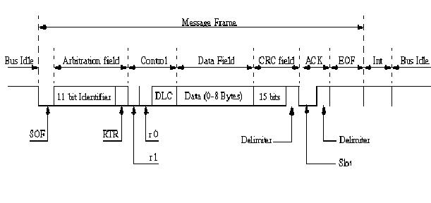

CAN use a specific message frame format for receiving and transmitting the data. The two types of frame format available are:
a) Standard CAN protocol or Base frame format
b) Extended Can or Extended frame format
The following figure (Fig 2) illustrates the standard CAN frame format, which consists of seven different bit-fields.
a) A Start of Frame (SOF) field - indicates the beginning of a message frame.
b) An Arbitration field, containing a message identifier and the Remote Transmission Request (RTR) bit. The RTR bit is used to discriminate between a transmitted Data Frame and a request for data from a remote node.
c) A Control Field containing six bits in which two reserved bits (r0 and r1) and a four bit Data Length Code (DLC). The DLC indicates the number of bytes in the Data Field that follows.
d) A Data Field, containing from zero to eight bytes.
e) The CRC field, containing a fifteen-bit cyclic redundancy check-code and a recessive delimiter bit.
f) The Acknowledge field, consisting of two bits. The first one is a Slot bit which is transmitted as recessive, but is subsequently over written by dominant bits transmitted from any node that successfully receives the transmitted message. The second bit is a recessive delimiter bit.
g) The End of Frame field, consisting of seven recessive bits.
An Intermission field consisting of three recessive bits is then added after the EOF field. Then the bus is recognized to be free.
(Fig 2)
Reference:
http://www.eeherald.com/section/design-guide/esmod9.html

While CAN is common in automotive applications, there is nothing at all about that signal that suggests CAN to me. CAN uses differential transmission and unless the bit pattern happened to work out "just so" so that a much larger number of bits look like 29 (plus, as I contend, a 30 that merges into the idle state), there are far too few bits at a rate far to low to be CAN.
The only thing that prevents me from being totally convinced it is just weird upside-down conventional async serial is my uncertainty that there is a STOP bit at the end of what would be the second character (20th bit from the left, counting from 1).
The apparent bit rate is inconsistent with 1-wire.
