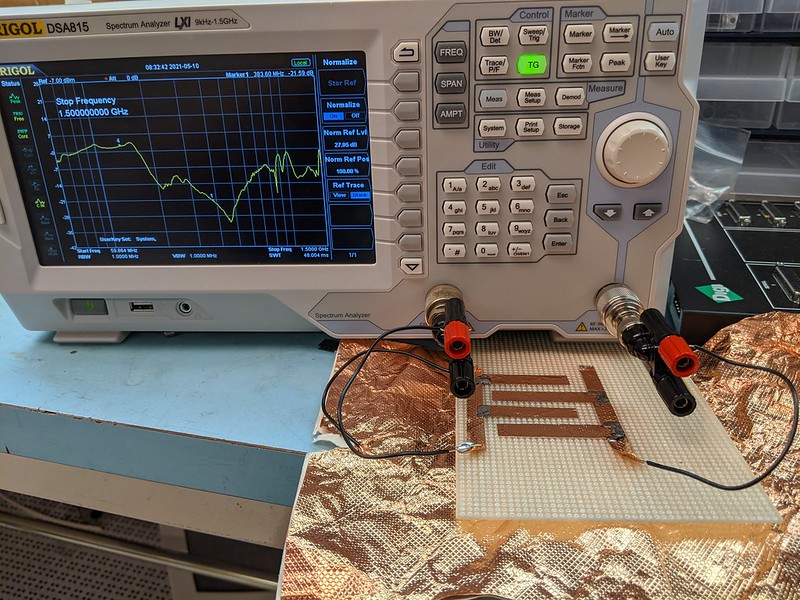

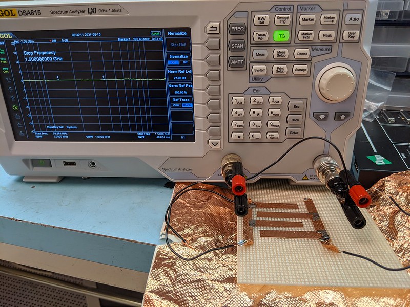

16,515
What type of measurement instrument would you use to analyze this type of circuit?
A VNA is what you need to fully analyze this type of circuit but a spectrum analyzer with a tracking generator will give you a general idea of the device RF parameters.
https://www.edn.com/using-a-tracking-generator/
Normalized frequency response of a wire.
A quick and dirty Interdigital Filter response plot using that normalized wire calibration.
