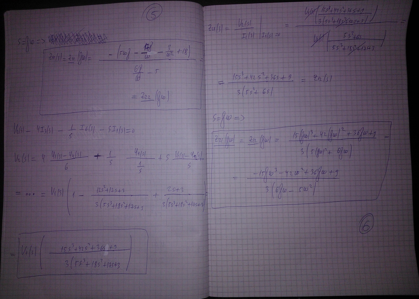

xxxyyyba
Joined Aug 7, 2012
289
z11= z22 = -(w*5*i - (17*i)/w - 3/w^2 + 18)/((6*i)/w - 5);
z21 = z12 = ((((6*i)/w - 4)/(w*15*i - (51*i)/w - 9/w^2 + 54) + ((24*i)/w - 20)/(w*15*i - (51*i)/w - 9/w^2 + 54) + (w*((6*i)/w - 5)*i)/(w*5*i - (17*i)/w - 3/w^2 + 18) - (((3*i)/w - 2)*i)/(w^3*(w*5*i - (17*i)/w - 3/w^2 + 18)))*(w*5*i - (17*i)/w - 3/w^2 + 18))/((6*i)/w - 5);
I tested it using Multisim and it's good. Thank you all for help :)
The Electrician
Joined Oct 9, 2007
2,970
Checking your results, I find that your result for Z11, Z22 is correct:
But I have a different result than you do for Z21, Z12:
If you transcribed your Z21 result into this forum by hand, rather than by copying and pasting, it's possible that your error is just a transcription error, but I copied and pasted your expression from the forum post into Mathematica, so there shouldn't be any transcription errors there.
