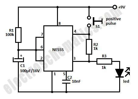

It is a very simple matter to add a single transistor to invert the BMS signal (as in the circuit below).
The transistor (Q1) can be almost any NPN low power device with the base resistor R chosen as 47KΩ, would only require minimal gain from the transistor for the circuit to operate correctly.
Hymie
Joined Mar 30, 2018
1,347
Yes, although you have omitted the collector 4k7 ohm reistor.
But you have misunderstood the location of the 10uF capacitor, which you have placed in parallel with the supply diode.
This 10uF should be in parallel with the 0.01uF capacitor to 0V.
And your diode across the relay coil is shown in the wrong polarity.

In terms of the timer circuit, this 555 timer circuit will do what you want; with the trigger input (pin 2) capacitively de-coupled such that should the trigger input remain low (longer than the timed period), the circuit will give a positive output pulse period, determined by the component values Rt & Ct.
With Rt = 91kΩ & Ct = 10uF will give a positive output pulse of circa 1 second.
Hi
Sorry for jumping in, but I noticed that the timing diagram in post #7 looks a little strange.
VCC is shown going low and triggering the circuit. But that can't happen if the supply voltage (VCC) is at 0v.:confused:
Nor can the output energize after timeout. :(
eT
Hymie
Joined Mar 30, 2018
1,347
The circuit was taken from my 555 timer cookbook.
I think that the input is shown at Vcc and going to 0V, and not implying that the supply voltage to the circuit is reduced to 0V (this was explained in the book’s narrative).
Perhaps the circuit would have been better if a pull-up resistor had been included at both sides of the capacitor (to Vcc) – with a switch shown triggering the timer.
As has been eluded to within some of my posts, the input needs to be at Vcc and taken low (to trigger the circuit), and not floating or at some lower voltage.
But you have a point, a novice building the circuit may believe that they need to drop the supply voltage to 0V to achieve the waveforms shown.
