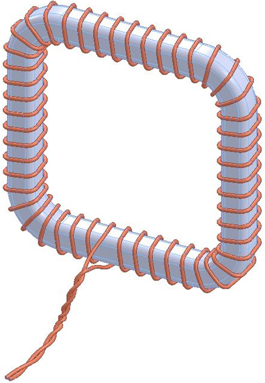

I have an educational single phase step-down/step-up transformer which is fed by a 120V Variac (Variable Transformer) that allows you to add as many turns as you wish ON THE SECONDARY (Insulated wire is used). Currently I am using the transformer as a step-down transformer with TWO TURNS ON THE SECONDARY (Ns = 2). I measured values for Vs (Secondary Voltage), Np (Set amount of turns which cannot be changed), Ns = 2, Ip (Primary Current), & Is (Secondary Current) with a Primary Voltage (Vp) = 10% on variac = 11.5Vac (.10 x 115Vac)
How would I hand calculate these values for when Ns = 3 at 10% on the variac before physically adding an extra turn? I am very familiar with using the transformer ratios for calculations (Np/Ns = Is/Ip = Vp/Vs). However, my calculation is not adding up for the new Vp? Can Volts per turn be used to calculated new values?

How big was the difference?
What is the physical construction of this transformer?
Note that with just two turns the wires connecting to that secondary can add or subtract a partial turn depending on the layout. Try twisting the wires like this:

In other words, after adding a turn, I needed a higher primary voltage to put out more voltage on the "load". Maybe I calculated it incorrectly?

Is there a load on this transformer? That changes things as the output voltage of a transformer under load depends (among other things) on the resistance of the windings. By changing from 2 to 3 turns the secondary resistance has gone up by 50%.

So you need to look at the open circuit voltage.
Im assuming you mean Open circuit voltage of secondary...so with a resistive load, this is the only way to accomplish this. Would I calculate the open circuit voltage and "adjust" based on load resistance? How would I calculate my values? Thank you guys so far for responding!!!!

Yes, you measure the voltage on the open secondary.
To calculate the effect of the load resistance you need to know (or measure) the resistance of the primary and secondary windings, and calculate the voltage drop from those (adjusting the primary resistance by the turns ratio) due to the load resistance current through those winding resistances.

Perfectly safe.
A voltmeter is normally such a high impedance that it will have little effect on the open circuit transformer voltage (for example typical digital multimeters have at least a 1 megohm impedance).
If the secondary is shorted then the current will be determined by the open circuit secondary voltage divided by the sum of the secondary and reflected primary winding resistances.

What would be the best way to measure the primary and secondary resistances? Im sure those resistances will change (increase/warm up).

If they are too small for reliable measurement with an ohmmeter, than you an run a known (measured) DC current through them and measure the voltage drop.
The wires may heat up some under heavy load but the resistance change is usually not that significant.
You can calculate that my measuring the transformer temperature under load after sufficient period of time for it to warm up and then calculate the resistance increase from the coefficient of resistance change with temperature for copper.

1. It can have as many turns as you like.
2. No.
Too many unknowns.

More turns = more voltage, as long as the load resistance is the same, and zero load current is a good thing.
Trying to calculate the sum of all impedances is a PIB. (Pain In Behind)
Measuring is so much easier!
Do not short a turn for more than a few seconds or you risk overheating the transformer.
