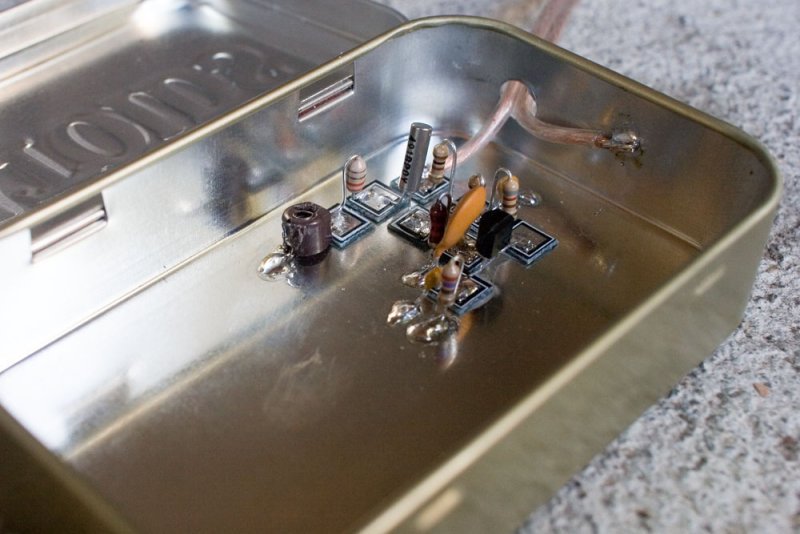

Proto with this for soldered connections and low freq RF capability.
Regards, Dana.
Great idea, but each one of those pads is a 5-10pF capacitor to ground. If you don't design for this extra capacitance, your RF circuits will never work as you want. Also, you need a rubber grommet where the lines come thru.
rubber grommet where the lines come thru? Could you please explain?
A grommet to prevent the sharp metal of the box cutting into the wire.
I have made a few things in a box like above but with "birds nest" construction. All the parts are soldered together with just their leads supporting them.
