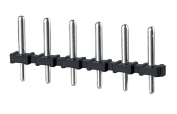

Hey guys,
I recently picked up 41 of Riacon ASP02 because the site has a minimum order of $30.
I thought they would come with headers because there were headers in the picture. They did not, so now I have 41 of these without headers.

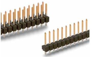

The headers are nonstandard, and as far as I can tell they recommend 31017108. I would just bite the bullet and get 30$ worth of these, but in the spec sheet they are THR (through hole reflow).
I found a little information online about THR, but none about doing this process manually without an expensive re-flow oven.
Anyone know if I can do this with either a normal soldering iron or a heat gun?
Could I do it with a re-flow toaster oven? Any tips?
I tried putting normal headers on by putting solder on the top of the pins and heating from the other side of the pin, but this did not work in the least.

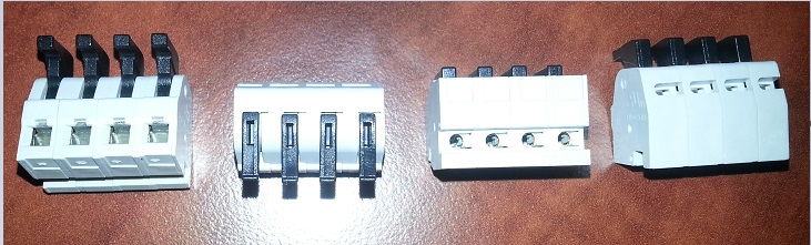

I am not exactly clear about your question. I have some similar terminals. The header is soldered on to the PCB. The wires are clamped into the terminal strip. The terminal strip plugs into the header on the PCB. This forms a removeable connector of sorts. The headers are 5mm spacing with .051" dia. pins. You can use a normal soldering iron to solder the header to the PCB. The header is not soldered/reflowed to the terminal strip.
Did this help?
Oaklandishh
Joined Nov 13, 2014
10

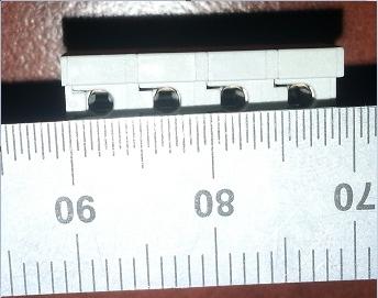

These terminals are quite difficult to pull up the clamp on, so I was under the impression that they had to be soldered to the headers rather than just clipping in.
You can kind of see this in the color of the headers as the top and the bottom are both covered in solder compared to other THR which only one side is.
I am pretty sure I can solder the side that sticks through the pcb, but I am unable to melt the side that is inside the terminal and I was wondering if I could do it without a reflow oven.

I contacted the company, and according to them, the thick side of the headers just press fits into the other side of the terminal.
This should make soldering these particular headers pretty easy.
Normally THR uses wave soldering, but it can be done with a good soldering iron.
Thanks for all the replies.
