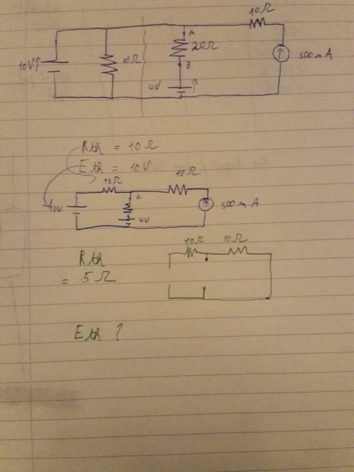

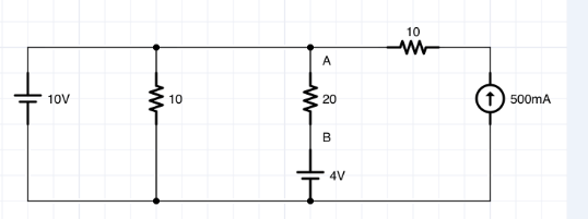

so i have this circuit and I need to determine the Thevenin Voltage between point A and B and the thevenin restistance, so that I can determine the current throught the load resistor.
I already determined the current ( 300 mA) with the nodal method, but I don't know how to do it with thevenin. I tried several times, but with no succes.

Yes I do I have a step by step way described in my book, but even tough I follow it. I can't get the results, for this problem. Other exercises on thevenin went fine.

So show your work so that we can see what you are doing right and what you are doing wrong. Just present your best effort to solve your homework so that we have something to start from.

Sorry I know it has been a long time. Actually it is not a homework problem, it was a question from a test. My problem with thevenin is that I don't know what to do when they ask for a voltage or current in the middle of the circuit. But here is one of my countless tries
