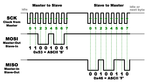

With SPI, it is possible to be sending and receiving at the same time, and it's actually quite common. It depends on the protocol used by the particular master and slave. For example, an analog to digital converter may be sending out the results of the previous conversion on the MISO line, while receiving the next request on the MOSI line.
