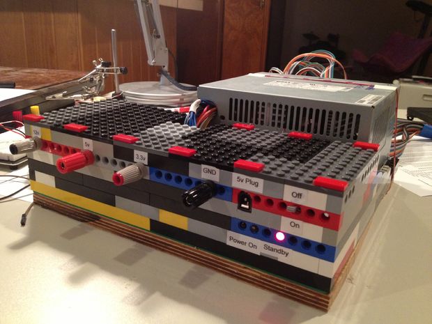

added a variable resistor to the feedback loop, and put 4mm terminals on the case, and changed the output caps to 35v or higher,depends which chip they use, as to how easy it is..some are easier than others..

you can, but the atx output is only 12v, if your going to make a psu for a bench i would start by modifying a laptop psu first, or make a linear one from a transformer .
