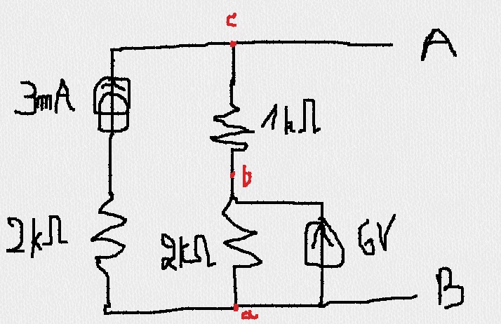

Hi everyone!
I have a simple question, but I have the impression I'm missing some important concepts of circuits. (especially open en short circuits)
this is the given circuit:
Asked is to give the norton equivalent of this circuit from A to B with the help of superposition.
turning off all the sources gives Ri=1kΩ
What I did further:
turning off the current source:
2 resistances in serie => Ik,1=6V/2kΩ = 3mA
turning off the voltage source:
the voltage over the 1kΩ is 3mA*2kΩ=6V
the currents are in parallel => Ik,2=3mA+(6V/1kΩ)=9mA
=> Ik=Ik,1+Ik,2=12mA
But when I don't think about superposition I can clearly see Ik=6mA due to 3mA+(6V/2kΩ)
What did I do wrong? :confused: I think there's a concept about short/open circuits I'm missing.
PS: sorry about the embarassing Paint-skills :p
gneill
Joined Feb 7, 2014
9
Hi everyone!
Okay, that looks good.
What I did further:
No, I don't see two resistances in series. I see a 6 V source in parallel with a 2 kΩ resistor and a 1 kΩ resistor. You're looking for the current through the 1 kΩ resistor. It might help if you sketched in the actual short circuit path; it's the current through the short circuit path that you want to find.
Ah, no. The short circuit guarantees that the voltage across the 1 kΩ is zero. All current will pass through the short and none will take the 1 kΩ path. Again, it might help if you were to actually sketch in the short circuit.

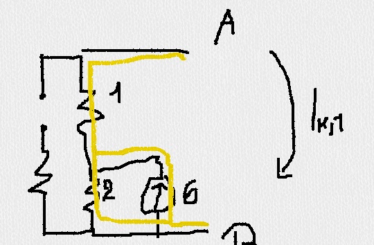

Thanks for your reply,
so:
gives a 3mA current through the 2kΩ. But how can you determine the current through the 1kΩ? Can I say that also 3mA travels through the 6V-voltage which results in Ik,1=6mA? And if so, why can I say that?
I understand that if you turn off the 6V-voltage point a en b are at the same potential, but why would the short circuit guarantee that theres no voltage between b and c? I'm afraid that's a concept i don't understand.
so:
<picture snipped>
Let's rearrange the circuit diagram a bit. The "broken" branch with the suppressed current source is omitted because no current can flow through an open circuit so that branch plays no part:
Note that the short circuit between the terminals A and B has been indicated. What's the current through the 1k resistor and the short?

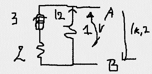

Again, redraw the circuit including the short between A and B:
The suppressed 6 V source has "taken out" its parallel 2k resistor. Note that the short between A and B parallels the 1k resistor. A short is equivalent to a zero ohm resistor... so that means the parallel combination of the short and the 1k is...?
