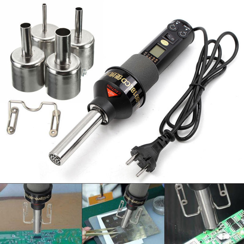

Removing with an iron is problematic for more than a few pads, but applying low temperature solder will help. It's best to use a hot air tool. I saw some cheap ones on eBay (~$30). I use an Aoyue 2702+; around $250.
