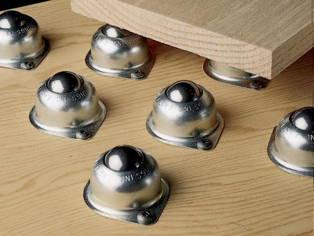

Something like these may work?
Max.
I need the bottom free of obstructions. I gave the analogy of the fat man on top of the table to illustrate that rigidity is needed in all axes. A more appropriate analogy would be: The disk in the table should be able to rotate freely, without lifting or dipping on any side, as a fat man swings from the bottom of the disk on a pendulum.
