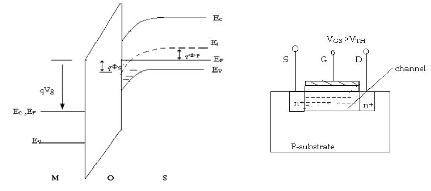

I would like to know what those vertical lines mean in this MOS band diagram. These vertical lines are at the intersections of both the metal with the insulator, and the insulator with the semiconductor. Why are they there and what do they mean?
Also, at the intersection of the semiconductor with insulator, all of the band edges, conduction, valence, etc, seem to be joined together with the vertical line. What does that mean? The metal fermi level also joins together with the left vertical line. Again what does it mean? Strangely, they join together at the bandgap, where there are no states available, so how can they just end up there?
Are the vertical lines potential barriers? So that electrons below the insulator conduction band, and above the valence band can't climb the barrier ? And electrons at the insulator conduction band or above can pass thru because they have the required energy? Similarly for the valence band?
Thanks a lot!

Looks like the parallelogram is the oxide layer in your drawing.
M O S Metal Oxide Silicon in the diagram.

They represent the molecular interface between the M O S regions ie: the junctions of the different materials,
On paper they are just drawing lines, I don't see why you having a such problem with such an obvious depiction of voltage barriers.?

Added: edited your image.

That is interesting. So the fermi and conduction bands split from the metal, through the oxide, until they appear well apart at the semiconductor.
And the metal has a valence band showing as well. Why don't they usually show it on a band diagram? Implicit? :)
qPhi(zeta) is the energy difference function from the metal Ef and Ec through the oxide? Wow!
OK, so you said the vertical lines are energy barriers. Could you say more about that?

I guess you know that the interface junctions between the M O S materials are not just physical contact junctions.
They are grown, doped junction and are only few nanometres thick.
The different voltage levels for MOS devices are well documented on the web and there is no point in me retyping that data.
I have found the attached document, which explains the voltage barrier voltages. I hope this will answer your query.

The way I see it, lets say post in #6, page 3, figure 1.3. The vertical lines on the sides of the white region are the physical edges of that oxide layer, on the X axis. The Y axis represents the potential required to overcome the oxide barrier at left and right side of the oxide.
The same here in 6.2.1 https://ecee.colorado.edu/~bart/book/moseb.htm - see the x axis labeled Position in nm?
