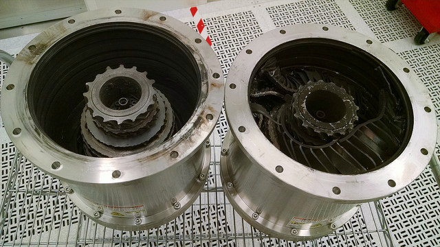

Need to reduce catastrophic failures of vacuum systems that can result in large repair bills by vibration and heat analysis of high kinetic energy components during operation. The plan is to generate controller power from mechanical pump motor heat, use that power to enable BLE connected vibration, acoustic and heat sensors on Maglev turbo molecular pumps that can signal the main control system to safe the vacuum system before it explodes like this.
Pump mount plate.
I'm trying to see if a precursor signal pattern can be detected to a high probability at least 60 seconds before destruction but I expect only a few seconds at the most.

I had a similar nemesis in a device we called a Chem Pump. The pumps we used cost just over a hundred grand, a rework cost about twenty grand using available rework kits but if one crashed we were looking at about sixty grand. The units are, as the link mentioned, canned. They pumped grade A water with about a 2,000 PSI blanket of nitrogen at about 600 degrees F. Predicting a failure was a PITA to say the least. Each pump was instrumented with 5 thermocouples and then we added 3 accelerometers. Gave the pump a normal run and started collecting baseline data to establish high limits for vibration. I got pretty good at determining mean failure times. The problem was all three accelerometers plus 5 thermocouples were wired and using 8 Analog Input channels of data acquisition. I never saw a way to make the sensors remote and self powered. The accelerometers were either B&K or Endevco with charge amplifiers. Not the sort of stuff you buy on Amazon. :)
While stopping a hot test midway through sucked and required a pile of paper work it did save big bucks. A normal hot test ran 48 to 72 hours depending on what product we were testing. The idea was to accurately guess looking at run time hours on the pump and where my last vibe limits were to know enough to swap out a pump before a major impeller crash. The accelerometers were the real help. Once I collected enough baseline data we got real good at predicting failure.
While wireless self powered is sweet I doubt we would ever get there mostly because wireless anything is a big not going to happen because of the data being transmitted. :) I still enjoyed reading the white paper though.
