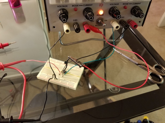

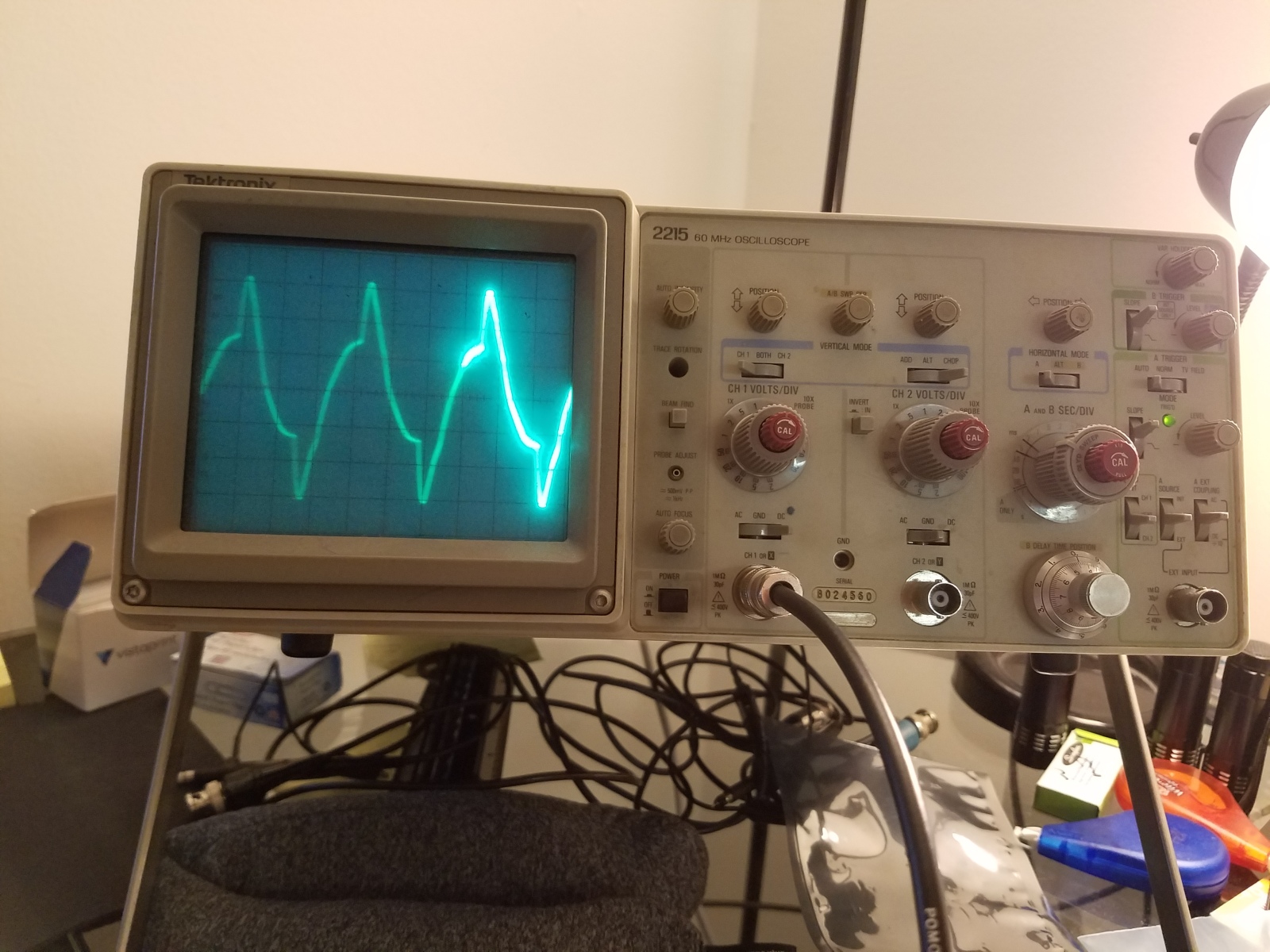

I've wired up a simple non-inverting amplifier, using LM358N, and I'm getting some strange output on the scope. Thanks ahead of time, I know it can be a pain troubleshoot simply by looking at pictures of a circuit.
[/url][/IMG]

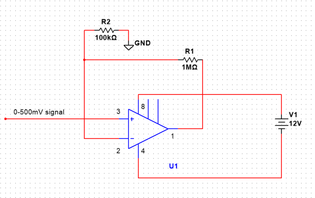

Here is a picture of the circuit
Rf = 1M Rin = 100k so I'm looking at a gain of 11. Vcc is 12V and my signal to the non-inverting input is 0-500mV.
So, am I missing something? Bad op amp? Thanks!

What you are looking at is 60Hz noise.
As far as I can tell, you are making two common mistakes with your GROUND connections.
1) LM358 can run on single supply or dual supply. You have chosen to use single supply (PSU) but your supply is "floating". It has no reference connection to EARTH GROUND. Jumper the WHITE (-ve) banana jack on the PSU to the black (GND) jack.
2) Your input signal is not referenced to GROUND. Do the same. Jumper the WHITE terminal to GND.

4. I suspect that might be where my issue is but I'm not sure how to fix it. It is a dual mode power supply so maybe I have a ground problem? The digital ground in my circuit represents the negative of PS1 and the ground is the negative of PS2

It is not clear from the photos what is your input signal. I thought it was PS1.
Ok, if you are using a dual power supply, here is how to connect them.
Assuming we are using PS1 as negative supply and PS1 as positive supply
PS1
- GND +
PS2
- GND +
Connect PS1 GND to + (i.e. BLACK to RED on PS1)
Connect PS2 GND to - (i.e. WHITE to BLACK on PS2)
Any of these is your GND reference. Connect this to the GND of R2 and the GND of your signal source.
Connect PS1 - to LM358 pin-4
Connect PS2 + to LM358 pin-8

Thank you, that solved my problem!

Actually PS2 is my Vcc and PS1 is my signal. Tying both negatives to earth ground fixed the problem
