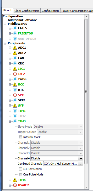

I want to do a rpm counter. I also have a problem with the hall sensor. STM32F103C8 microcontroller, sensor such https://www.aliexpress.com/item/329...ail.1000016.1.333239a3rFRUR9&isOrigTitle=true , IDE Keil 5.

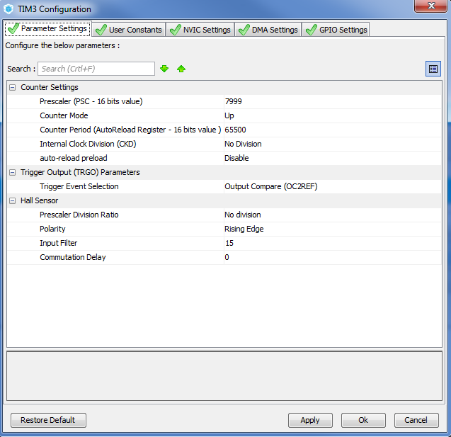

Setting the clock:

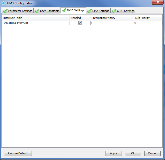

Setting the timer:
If I understand correctly, 1 "tick" of the timer is 1 microsecond.
The D0 pin of the hall sensor is connected to timer 3 input 1. The function hallSensor is called in a FreeRTOS thread.When I bring the magnet to the sensor, I get into the interrupt. In debug mode, if put a breakpoint on rpmTmp = 60/halfCalc; I get a value. But I am not sure of its correctness. If do not set a breakpoint, the RPM is not calculated at all and is always zero.
