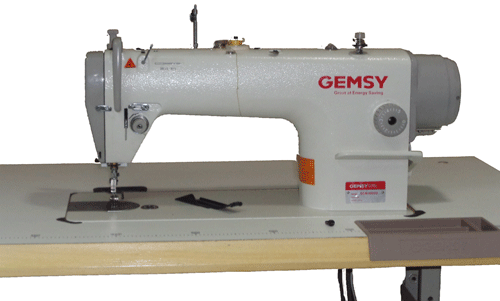

It looks like, from your picture of the motor, that there is a pulley on the motor, so that means there needs to be a belt also. Are you sure that the belt is put on correctly? Some machines with a Vbelt use a 'half twist' to reverse the final drive direction.
Also is this motor original to the machine, or is it a "refit", a different motor being put on the machine? I ask because you mentioned, "There is no other orientation that I can figure out to turn the motor 180 degrees to "mechanically" solve the issue."
Half twist! Very interesting. I think the length of the vbelt prevents the use of a twist? Would friction not be another issue with a twist?
This is the original motor. Not a refit.

Is this a 880D1 model? If so it shows the actual motor direction as CCW when looking into the end of the shaft. Is this how the motor is rotating on yours?

There was no "rewiring" with the rebuild. The motor can not be installed in any other orientation... Hummm... I am sure there is an easy answer - just not coming to me...
In the rebuild was the belt replaced? If so maybe the wrong size belt was put back on. The half twist as shortbus mentioned would fit this scenario.

Some small machines at one place I worked did this. Also a very old snowblower I had used two different belts to drive the wheels, one like normal for forward, one with the twist for reverse. Depending on which one was tightened by an idler pulley the direction was changed.

It may be that there is a lot more than is obvious. Some universal motors have an internal means to change the rotation, and some controllers output a voltage that is pulsating DC. And some motors have brushes and a permanent magnet field. Those motors are polarity sensitive.
So the first thing to do is to get a meter and check voltages and see if perhaps some polarity was reversed someplace. And I doubt very much that it is a BLDC (Brushless DC) motor, because ALL of them require an electronics package to drive, either internal or external.
BUT WAIT!! You stated that the motor is under MCU control. Where is the MCU in the circuit? I am guessing that the MCU, wherever it is, controls the speed of the motor.
Please let us know how they all hook up, because something does not sound quite right.

What is the model number of the Gemsy?
A photo of the machine and how the motor is attached would be useful.
This is a Gemsy 8800D

I suspect it is related to #4 in post 15. The motor was turning in the right direction but was mounted wrong.
