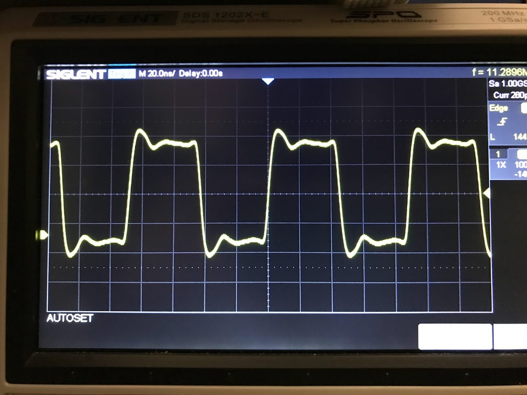

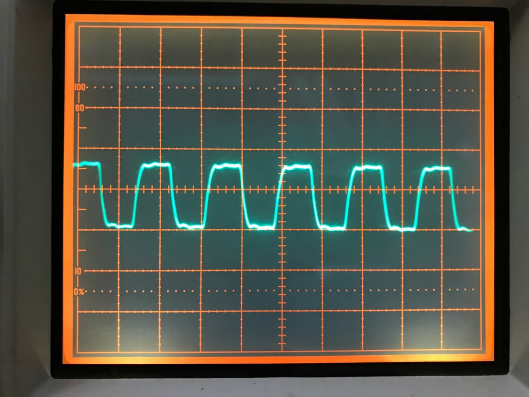

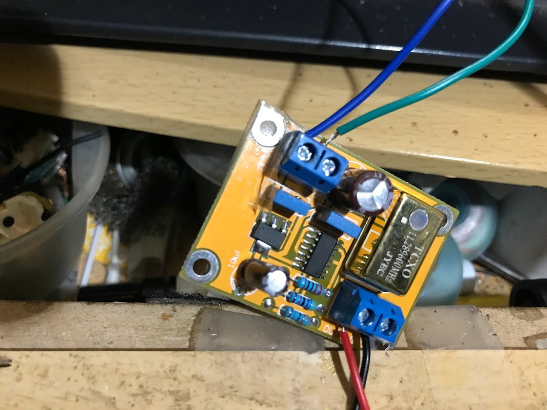

That does not explain two things:
1)the 27 Mhz osc is connected as directly and as cleanly as possible, see photo ; 2) Why the Tek 465 is relatively quiet.
Maybe I missed it but where is the RF choke and bypass filter for the power pins on the chip and maybe a decent ground plane that shields RF energy. Maybe the TEK signal display is the one that's bad.

I am having a hard time following the troubleshooting technique being employed here which seems to be trying to prove the Siglent is bad rather than get at the root cause—but that could certainly be just me and the relative inattention to the thread.
My initial reaction was something like (relatively) poor transient response of the TEK, possibly related to the higher effective sample rate of the DSO which is a higher bandwidth scope. I wonder what the calibrator waveform looks like...

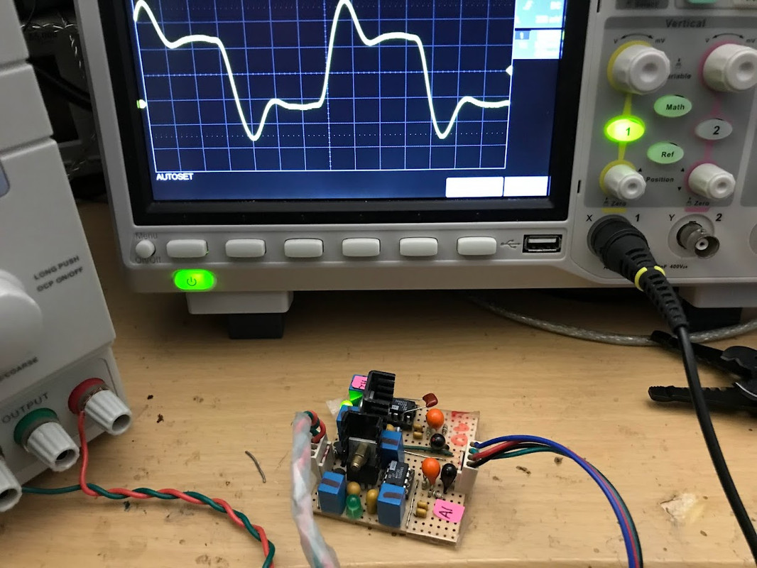

So, to recap, you use a signal from a DDS and you get pretty clean signals, but the 200 MHz scope shows more high-frequency artifacts than the 100 MHz scope. Not surprising.
Then you have an oscillator without proper bypassing and long power leads and the signal is considerably worse on both scopes, but again the 200 MHz scope shows more high-frequency artifacts than the 100 MHz scope. Again, not too surprising.
Many scopes have a bandwidth limit option. Have you looked at the waveform with that turned on? The limit might be too aggressive to be useful.

Another thing that can be easily missed is the ground connection on the probe clip.
The connecting wire on the ground clip is intentionally very flexible and is often broken close to the ends where it flexes a lot.
If this wire is broken then you have no ground connection at the probe. This will definitely manifest as ringing in HF signals.

Probing with the probe tip ground clip can eliminate issues related to faulty ground leads or the parasitics of the ground connection. Did the TS ever try reconfiguring the group and making more regular and rigorous connections to the DUT? I can’t find that anywhere.

Most of us know it's the nature of the beast to have scope probe artifacts. If you want perfect digital signals on a display then use a MSO to see the digital version of what that analog signal looks like.
Small changes in grounds or signal wires can easily cause measurement artifacts unless you use something like ground springs and bare probe points to reduce loops.

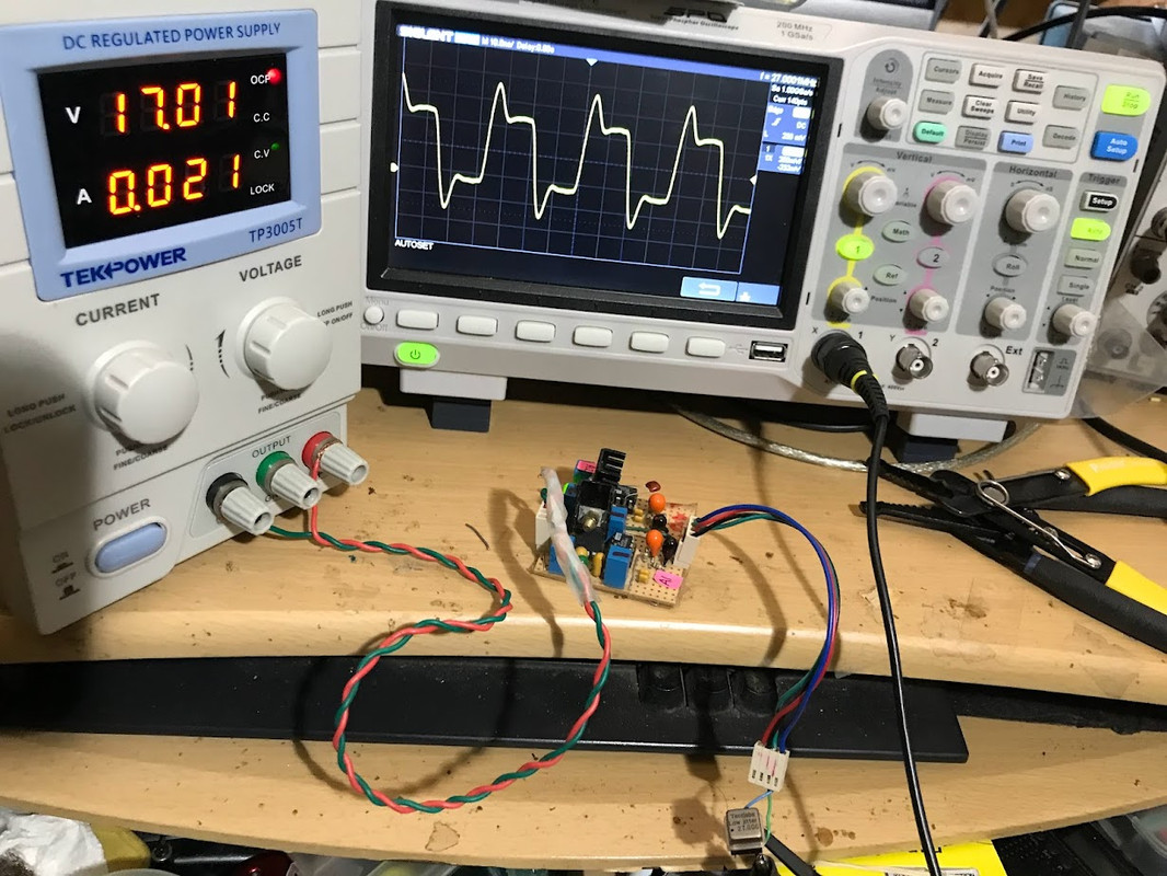

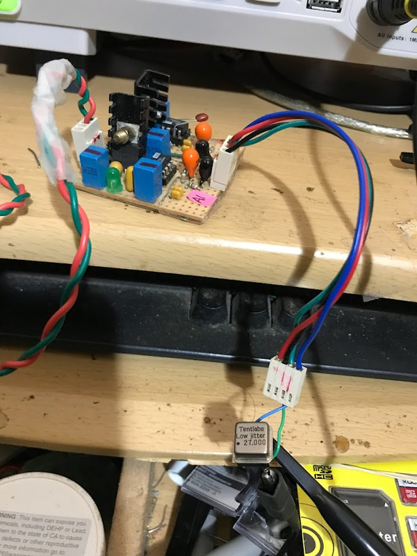

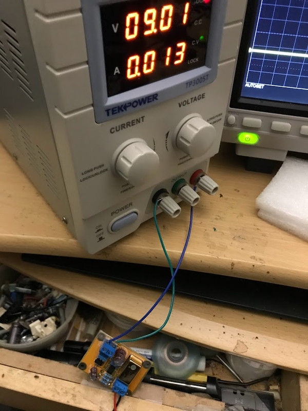

Showing my work ...
I used a very clean, high-fidelity regulator that I built; it outputs very low-noise 5Vdc (the optimal input voltage is 15-18vdc, as shown). It is meant for audiophile use.
I connected the 27Mhz osc to this clean reg, and soldered in very short power leads as close as possible to the 4 pins.
Results ...
And without the, per the manufacturer's recommendation, "an additional RF choke ("bead"). This will prevent radio interference, and should be used in combination with a decoupling capacitor closely positioned to the XO module."

The new setup seems to have eliminated some parasitics and so the ringing. But the under- and over-shoot is still there. Could be capacitance of the probe ground lead which is still a big piece of wire between the output and the scope.
Figure A is an 11 MHz square wave from a Siglent SDG 2042-X function generator connected to a Siglent SDS 1204X-E oscilloscope using a 50Ω, 1M BNC to minigrabber cable, clip to the scope’s suppled probe set to 10x.
Figure B is the same source connected using a BNC to scope probe adapter directly from the output connector.
figure A
figure B
The Siglent scopes are quite good and the distortion is not happening in the scope.
The other osc. I used (11.288, based on the sn74vlvc1g04 datasheet ckt) did employ a ferrite bead -- look carefully at those photos. In fact, I experimented with all sorts of bypass and decoupling caps and R's to tamp down that spike. No go.

Frankly, this is nonsense. You have been holding yourself as an outsider and consistently ignoring attempts to help. You complain about people not being simpatico yet you make yourself very abrasive.
My reproduction of the important bits of your set up was to show you that parasitics alone can and will cause the problems you are seeing by leading to an impedance mismatch. That one instrument is much more sensitive to the mismatch than the other is an interesting observation but a distraction.
If you want to use the Siglent—a much more a capable instrument—then you have to match the impedance. The first step in this is to eliminate the (relatively) large loop of wire that is the probes ground. Your probes came with a little spring that can be placed over the ground contact when the minigrabber hook of the probe is removed.
It makes the distance from probe to ground very small. You need to manually probe with that ground connection before you can say you tried the solution that everyone has been offering you.
The distortion you are seeing: overshoot, undershoot, and ringing are classic signs of impedance mismatch and poor probing. If you won’t even try to test the theory that it is the source of the problem, what more can be expected from us? The suggestion that you borrow a scope was made because it might show you that it is exactly the same on the other scope and so you‘ll take the advice being offered.
You can’t expect us to go against our own experience because you don’t like the answers being given. Nor should you expect us, due to some vague obligation, do what you think is a good troubleshooting step on our own time when you won’t do what we think will provide the solution, first.
