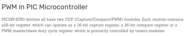

Hello guys i have some question regarding PWM.
What does it mean by pwm master-slave?? Why it is called master-slave??
BobTPH
Joined Jun 5, 2013
11,661
I think they are referring to the fact that there are actually two registers, You write to one, then, at the end if the next PWM period, it is copied to the actual register. This allows updating the register without disturbing the current cycle.
