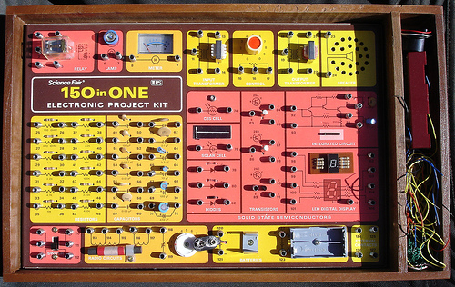

When I was young there were some common terminals, some just spring steel stampings (Fahnestock Clips), some with springs for compression, either could be used to set up temporary wiring. You may still see such used in those 150-in-one electronics kits, but I have no sources for the kind I used to insert into blank perf board.

Can't find my samples right now.:(
Before proto boards there were uprights with little springs. Springs about the size of retractable ball point springs but half the length.
I'll try a search.

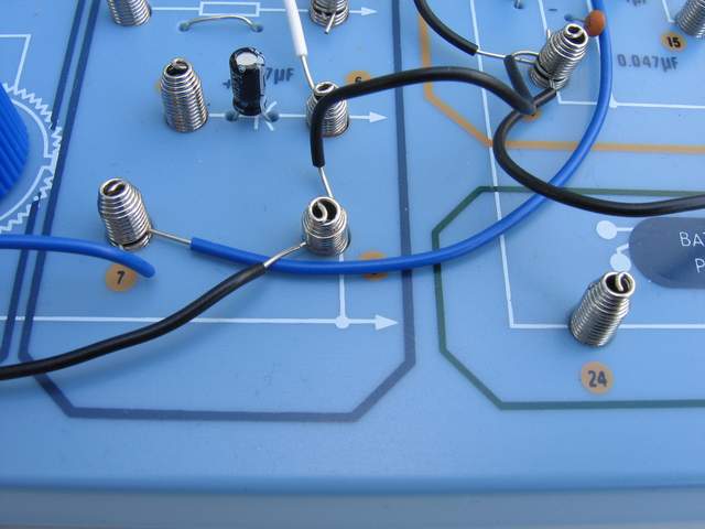

inwo
Joined Nov 7, 2013
2,419
You mean these spring clips?
No, but that's what got me thinking of them.:D
They are a flat pressed steel pin. Rolled on one end to fit in a perf board hole.
The rest of the body is slotted for wires. A coil spring over it. Held in place by a cross piece in the slot.
Wires inserted much like the ones you show but more stable, as they fit thru the slot.
spinnaker
Joined Oct 29, 2009
7,830
Do you mean these?
