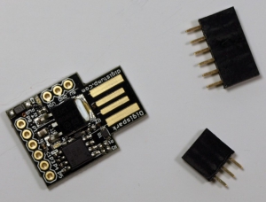

Attiny85 does not have the USB interface. It is made software from pine that can be only 1 or 0.
Question ?
Can I give up the voltage regulator from this scheme?
Attiny85 works to 5V. The USB the same.
But maybe it needs 3V3 for the USB high speed protocol.Or not ?

Wait a minute, is the Tiny85 playing the part of a host or an endpoint?
Attint85 is a device attached to the computer. Is a endpoint (peripheral device).

Actually, this arduino is an Attiny85 which is already programmed with a bootloader.
That boot program, knows the USB protocol, and write the program memory with what it receives on USB.

Does the digispark board not come with functional USB? Seems kind of a fraud if it doesn't.
FWIW, the regulator is for external power.
