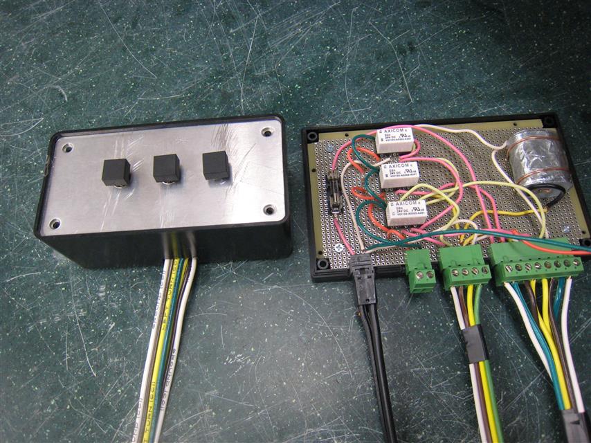

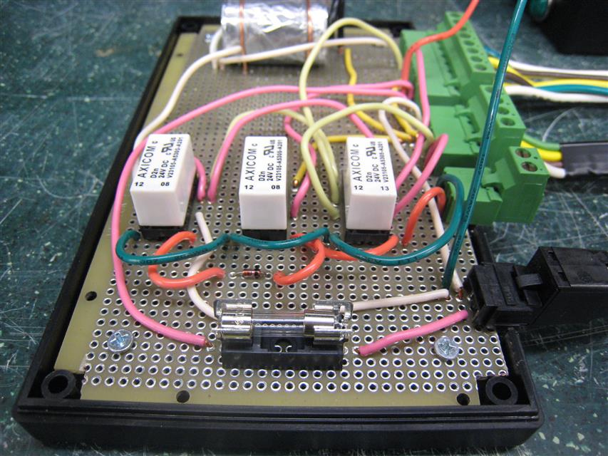

I have a reversible AC motor that is activated by a 5v DC trigger using 3 relays. Problem is I am getting some sort or "noise" that is effecting the circuit that is triggering the relays. From my reading it seems maybe I need some sort of snubber on the motor. Problem is that I am not really sure how to do it or what to use.
This is the motor http://www.grainger.com/product/DAYTON-Gearmotor-4Z062?searchQuery=4Z062A
These are the relays: http://www.digikey.com/product-search/en?vendor=0&keywords=V23105A5301A201
I attached a Schematic of what I have and picture also.
