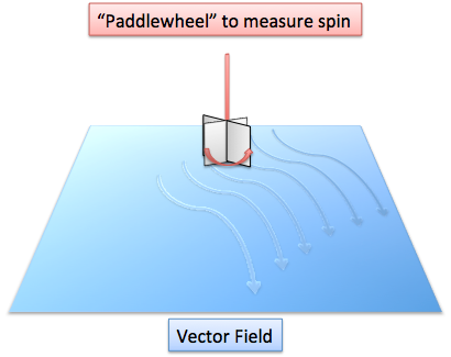

May I also request you to kindly help me visulaize the 'Curl of an Electric Field'...!! I understand to some extent that a curl is a measure of rotation of a field... I can visualize the curl of magnetic field around a wire carrying current as a 'circle around the cross section' of the wire... Would curl of an electric field also have to be 'assumed' to be a similar circle around the cross section of the wire...??

An intuitive view of curl.
A flow of water.
If the paddle turns, it means this field has curl (twisting or pushing force) at that point.

Hi,
Your drawing inspired me to make a drawing too in order to help illustrate in post #14. I attached it there.
Nice drawing BTW :)
It might be worth mentioning that to measure the curl of B that paddle wheel could hypothetically be placed in the field with the shaft perpendicular to the flow of current. The difference in B near the wire and farther from the wire would cause the wheel to turn. That makes it seem like the current is causing the rotation like a corkscrew where the handle turns like the curl of B and the current advances like how the screw goes into the cork. As the screw keeps moving forward, the curl keeps rotating around the screw. The curl however is not a spiral it's more like just circular lines.
