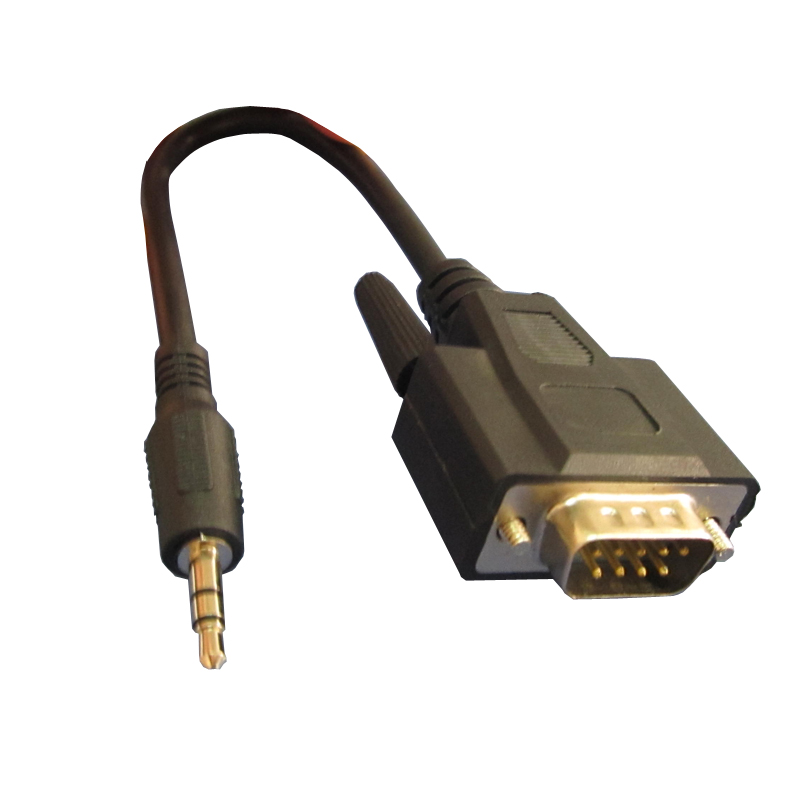

shteii01
Joined Feb 19, 2010
4,644
If you use sound card, a cable like this might be helpful (or not). I got a similar cable from work when they were throwing random stuff away. That is the only reason I learned of its existence. I would have never though of combining 3.5mm audio jack with DB9.
