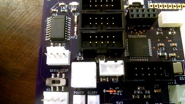

Another thing about self-test is what happens when a system fails. Is there redundancy to keep the system safely running and/or is there a builtin backup for things like on-board power failures.
bug13
Joined Feb 13, 2012
2,002
Just curious, why did you use a through hole part?
