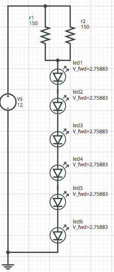

Recently I got hold of an LED pcb that has two independent circuit and each consists of 6 high power 5730 LED beads (Vf=2.759V each) with two 151 SMD resistors (150 ohm) and a swtich. The whole thing is powered by 12V DC and draws 100mA when both circuits switch on and 50mA when only one of them is on.
With a hundred 5730 LED beads in hands, I'm trying to design a pcb with different layout but using the same circuit.
However, I still couldn't figure out how is it possible to power up 6 LEDs with only 12V in each circuit.
I've come up and simulated several combinations on connecting the LEDs with two resistors.
#1: This obviously wouldn't work, since 2.75883*6=16.55V > 12V

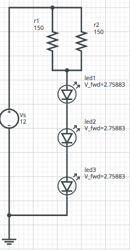

#2: This circuit successfully draws 50mA, but can only have 3 LEDs. I need 6.

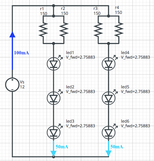

#3: This works fine for 6 LEDs but now the circuit draws 100mA and I have two extra resistors.
None of them seems to meet the requirements of 6 LEDs, 2 resistors, 12A and 50mA.
Is there any other combination of circuit that would fit the criteria?

In your third circuit, take out one of the two 150 Ohm resistors on each branch. That should approximately cut the current in half.
On the other hand, what are the LEDs rated for? If they can handle 50mA, maybe you only need half as many running at 50mA.
Bob

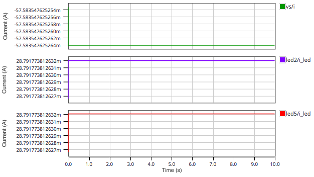

I have omitted one resistor from each branch.
But the simulation result showed different values.
Each branch draws 28.79mA. The circuit draws 57.58mA.

But what is the point of using smaller resistors at the expense of having 3 times as many resistors and LEDs?
At Vf of 3.4V we can calculate the resistor needed to get 150 mA:
R = (12 - 3 * 3.4) / 0.15 = 12 Ohms
And the power is I^2 * r = .15 ^2 * 12 = 0.27W
But your sim results assume certain behavior on the part of the components; behavior that may or may not be highly accurate. Your results are just a bit more than 10% off from the 50 mA you mentioned in the first post. Where did that 50 mA number come from? Actual measurement? Where did the 2.75883 V value for Vf come from? Is it really good six sig figs? What is the internal resistance of the voltage source that is actually being used, as opposed to the ideal 12 V source in the sim? What is the tolerance of the resistors?
Let's just use the Vf = 2.75883 V and see what a hand calculation would predict:
I = 2{[12 V - 3(2.75883 V)] / 150 Ω} = 49.6 mA
Remember that sim results are only as good as the models used. If you use simple models, then expect the sim results to just be in the ballpark (if that). In most such cases, anything better than 20% agreement is probably "in the ballpark".
