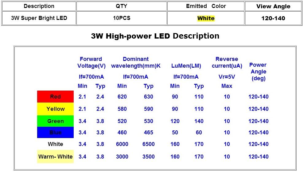

I dont know if you have skimmed through the entire thread. Here is the datasheet for the LED http://www.ebay.com/itm/10-X-3W-White-HIGH-POWER-Star-170LM-6500K-140-3watt-LED-/120989910849?pt=US_Car_Lighting&hash=item1c2b8f8741
I am running 10 of the white LED in series on a single Mean Well LPC-35-700 constant current driver. The spec sheet to the drivers is here: http://www.meanwell.com/search/LPC-35/default.htm
What is to blame here, the driver giving about 850mA or the LEDs?

The CHEEP (cluck, cluck) Chinese LEDs do not have a detailed datasheet that spec's their required cooling so they will probably overheat then fail soon.
The CHEEP driver does not meet its current-limiting spec.
Why buy lousy CHEEP foreign junk instead of good name-brand stuff?

The spec sheet for the Mean Well power supply says it has "Constant Current design with 5% accuracy". Then why does its output current slowly rise from 700mA to over 800mA?

Meanwell is the TOP (#1) name in LED drivers.. They are NOT "Cheap" Chinese crap.. (but the LEDS are :) ) Meanwell is well know for their reliability.. but like any company sometimes stuff happens. Its possible you have a bad driver. (But I doubt it)
You can always send them back for a replacement if you are 100% sure you are getting an accurate current reading.
And seeing the image of the heatsinks you will have NO PROBLEMS running them at full current.. (remember thermal compound should be applied as thin as possible or its just hurting the temps)

Measure the voltage right at the driver output with it all hooked up. what do you get? maybe try removing 1 LED from the circuit and see if its more stable. You might just be running at the max and it can't regulate properly due to the Vf from the LEDs and added resistance from the small wire.

MCGYVR, you were right from the start about the multimeter, except it wasnt a calibration issue, but a bad battery. I went out replaced it, and now everything is working below 735mA. Now a few things i should ask before i finish this off.
What is the max temp that these type of 3W LED's can withstand? I will be checking the temp with a IR Thermometer to look out for if the enclosed box with fans can stand the heat.
