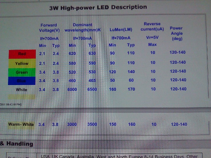

The Given:
Power source = 19VDC , 4740mA
LED's
White Min(3.4V) Typical(3.8) @ 700mA
Blue Min(3.4V) Typical(3.8) @ 700mA SAME as whites
Red Min(2.1V) Typical(2.4) @ 700mA
What i'm doing:
running a total of 20 white, 5 blue, 8 or 9 red. Each color will be it's own series and white will run 4 strings (in series). Trying to run whites at 3.6v so...
R= (19v-(3.6 x 5))/.7 = (19-18)/.7 = 1.43 Ohms, next highest 1.5Ohms.
Would it be better to run it at 1.8Ohm?
I tried that setup with 1.8ohm 1watt, and it seems to be under the .7A LED rating and the resistor stays warm to touch. (Is it supposed to be warm at all? it will never be cold live?)
Since the blue LED's were same ratings as the whites, i am doing same thing. 5 in series, but when i try the same resistor (1.8ohm 1watt), they are not warm to the touch but actually get kinda hot, cant hold it longer than 10 seconds.
The reds i tried 8 in series on it's own resistor. The resistor is 2.2ohm 1watt and seems to be same warmth as the white one. I believe when i measured these they were under .7A as well.
My question is, why were the blue LED's measured at .8 Amps if they are the same rating as the whites and same resistor used?
Am i doing this right? Any help or suggestions would make my day! :)

The blue LEDs probably display less Vfwd than the reds, despite their rating. (i.e. there's a reason these ratings have a range and even the "typical" isn't always typical.)

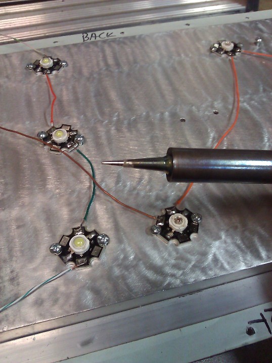

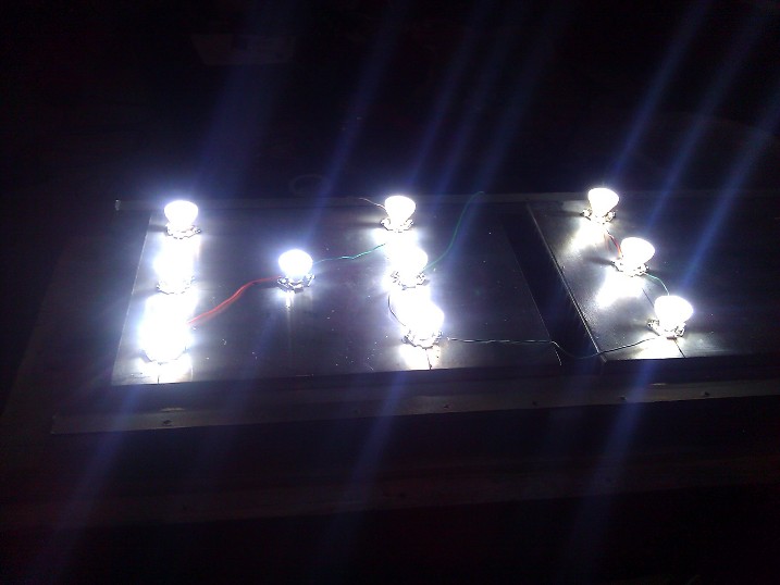

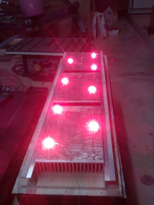

Here's some pictures to give you an understanding of what i'm trying to do.
The above is the power supply rating.
