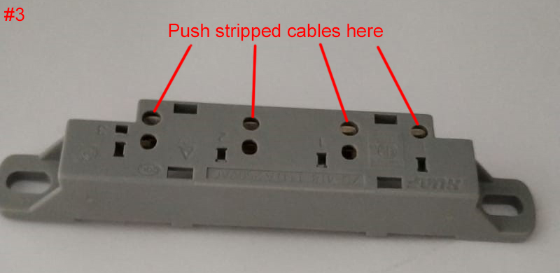

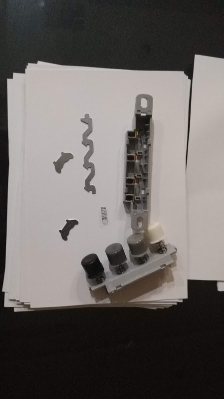

I bought this switch to replace a broken one on a fan. The broken switch had the electric contacts protruding outside of the switch on which one can solder the electric cables but this one didn't. So I took apart this switch as I wasn't sure how to connect / solder the electric cables (I still am not sure) and it fell apart and I cannot figure out how it should be assembled again. Does anyone know please?

Take more pictures, much closer up, front & back of all pieces! Where did the switch come from? Part number? Fan make & model? Fan front picture, showing switch pushbutton labels? How is the fan wired presently? Right now I can only guess the switch back has "poke home" wire connections that work with wires that are simply stripped, no connectors required. In your picture the long metal piece is the latch bar, it probably goes toward the right side of the (as shown) switch body. The spring goes on the top bump of the latch bar and sits at "OFF" button end of the switch body. No idea where the smaller metal parts fit.

Here are more pictures:

Definitely "no soldering required" connections. Stripped wires are just pushed into the holes, where the springy contact metal grabs into it. The assembly is obvious to me except for the two smaller metal pieces. Spring goes on latch bar at the white button end, the end with a ramp but no hook. What you call ground is the switch common, that connects to the "hot" (more correctly "line") wire. The white button goes at the switch common end. The smaller metal pieces are probably interlocks to prevent pressing 2 adjacent buttons down at once, but it's not obvious to me how they do that job.

So I figured it out (mostly). I re-assembled the switch and it is working well. The grey buttons stay in place and get disengaged by the white or another grey button. I tried what you told me and just pushed a stripped wire in those holes and yep it just stays there. I replaced the switch for the fan and it is working well. The only unknown are those two small metal bits. But hey it works.Thanks everyone for your help.

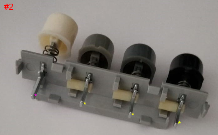

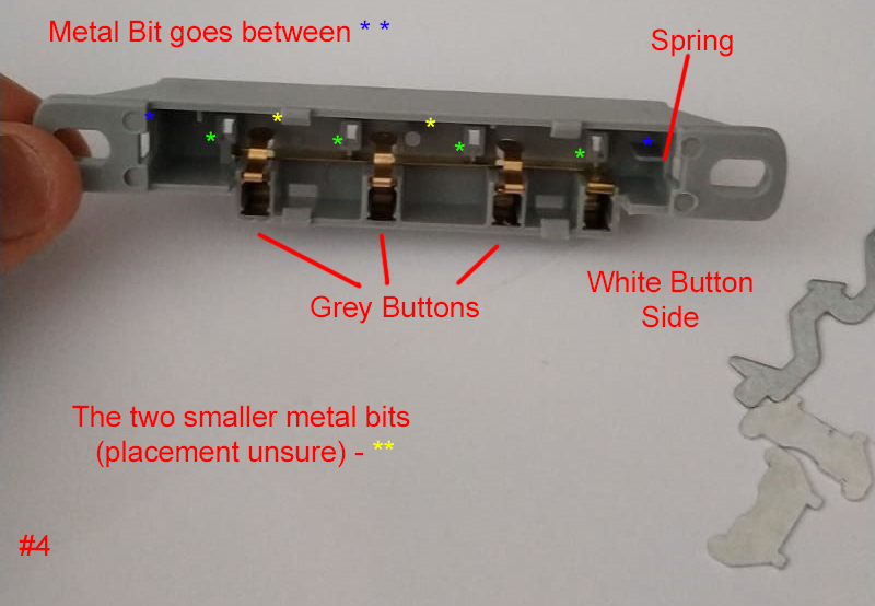

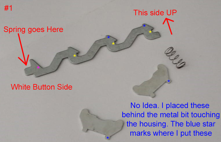

The spring goes at the end of the metal bit (let's call it zigzag bit) as shown in #1. The zigzag bit is then placed with the spring against the housing as shown in #4. The way it works when you push one of the grey buttons the metal bit marked with the yellow asterisk in #2 pushes the zigzag bit backwards and the spring then pushes the zigzag bit forwards to hold the grey button down in the bit marked with a yellow asterisk in #1. The way it works if you press another grey button it will first push the zigzag bit backwards releasing any other grey button, and then it is held in place where the yellow asterisk is. If you push the white button all it does is push the zigzag bit backwards where the pink asterisk is which releases all the buttons. There are holes in the housing where the metal bits of the buttons go into marked with a green asterisk in #4.
I wasn't sure where the two small bits go so I just put them between the zigzag bit and the plastic housing where the blue asterisk is in #1.

So the picture he provided is correct, and I was able to rebuild my piano key switches. However, the missing part of the puzzle - for me at least - is the little metal pieces, the ones that look a little like space invaders.
I found the following video: Fan teardown and reassembly
This screenshot nicely highlights where the main bar and spring is located, along with those little metal 'space invaders' pieces.
