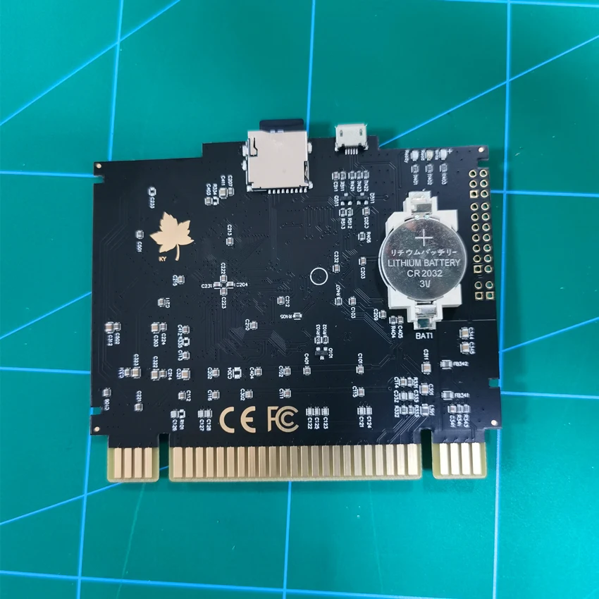

I have a PCB with a soldered CR2032 battery and I store this PCB for a long time. My question is whether the CR2032 will release an acidic or corrosive compound on the PCB, corroding it

No, unlike alkaline batteries which can suffer leakage, lithium cells don't. The cell will self-discharge over about 10 years, though. So, even if you don't use it, it will eventually be dead.

Really? I've found whitish deposits around the seals of several CR2032 cells kept for a few years in their original packaging in dry conditions.
Lithium manganese coin cells have gas release vents for cases of extreme over pressure. It is possible for the contents to migrate out from the cell in tiny amounts, which is what that powder is. Why it happens varies—high temperature, mechanical shock, and in some cases I think from excessive self discharge.
The difference is that the powdery stuff is not ever in a large quantity and it contains very little liquid. I have seen cells like you are describing but I have never seen cells that did anything like the pictures provided.
I wasn’t very precise in my description. Lithium cells don’t leak in the way alkaline cells do. And a PCB mounted cell could leak in the way that puts a white film on the cell, but it is standing off from the board, and can‘t do damage. I have a lot of old gear that uses CR2032 and larger cells PCB-mounted. I have never seen a board damaged by one.
I have to admit I am talking about good quality cells like Renata, Panasonic, and the like. There is an electrolyte that can leak from a coin cell, and there is a gas release vent, so with poor construction or materials, it‘s possible things could be worse than I have seen.
I will say that I am confident about storing PCBs with board mounted cells on them, but I could be wrong so take it as my opinion. I do remove coin cells from boards with holders if I am just stowing them and don’t have any idea when I would use them again but I don’t see the risk as great enough to desolder them.

From your experience, all these images are leaks from the CR2032 or something external that is not related to this CR2032 battery.
I don't know what the internal construction of the CR2032 is and if its chemistry undergoes reactions that turns into some corrosive compound for the PCB board and the metal fitting of this battery
the temperature where I live ranges from 33-35C is this enough for the CR2032 to leak?
my PCB not appears brand cr2032
https://ae01.alicdn.com/kf/Hfdf33a9...jogos-sd2snes-rev-x-vers-o-pro-diy-16-bit.jpg

The PCBs seemed to have water damage. The one bare cell did leak, but who knows why? To decide if the temperature is too high, the best thing is to find the manufacturer's datasheet which will specify storage temperature range.

yes i am storing it long term for years but if it doesn't leak i would keep it on the pcb and not open the devices but i don't know if it leaks or not
