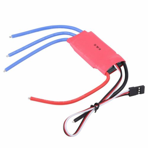

If you posted a picture of it we might be able to immediately say it's an RC brushless DC motor.
If so you can probably power it with this ESC (electronic speed controller) ("Probably" because it has to be rated for the amount of power used). You can drive the speed controller with an Arduino, or something even simpler.
